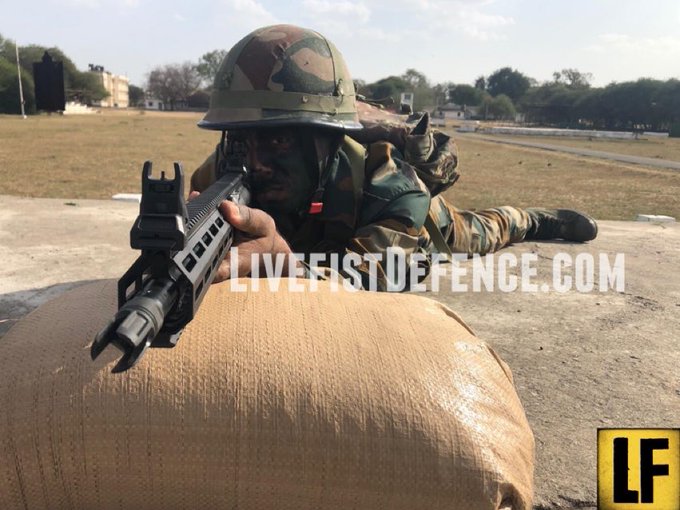

first time India is leveraging the inherent power of its weapon's buying program and the negative imports list
Livefist@livefist
BREAKING: After Indian Army's decision to abort deal, UAE's Caracal course-corrects, says will build the 93,895 carbines FULLY in India, says it has identified land, facility & local partners to begin production immediately https://bit.ly/2ZT2mqo
3:22 PM · Sep 21, 2020
