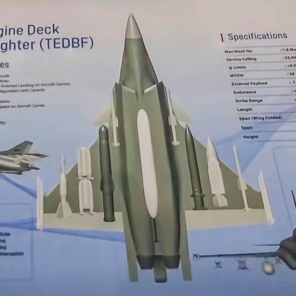

Cybaru wrote:New internal fuel - 6500 kgs. Compared to rafale which has 4700 kgs. I think last aero india there was also mention of 1.5K - 2K tons of fuel in cfts for tedbf. So all in all a land based version can replace Su30MKI quite easily.
But arent Rafale engines max wet thrust 75Kn and not 98 Kn for the F414.

Dry thrust is more relevant as afterburner is used only for a very small duration. Here, the difference is around 7 kN only.

basant wrote:Dry thrust is more relevant as afterburner is used only for a very small duration. Here, the difference is around 7 kN only.
Afterburner is important for take-off in stobar configuration.

BenG wrote:Afterburner is important for take-off in stobar configuration.
It is, as well as to accelerate when required. However, the total weight will have to be carried all the time!

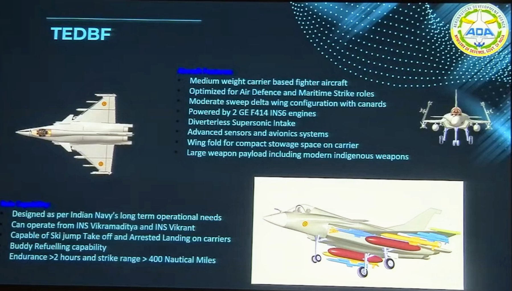

TEDBF is slowly but surely becoming a more refined design. The wing body blending has definitely improved and the radome shape has also changed, probably to address any intake airflow issues that Wind Tunnel Testing brought up.
Sorry, the ADA board didn't mention the internal fuel. So could you pls mention what is the source for the claim that new internal fuel is 6500 kgs?
Posts: 5926
Re: Twin Engine Deck Based Fighter (TEDBF): News & Discussion
That's right. The Specific Fuel Consumption is also higher for the F-414 as compared to the M-88-2.
All in all, the TEDBF should have an even higher range than the Rafale C/M.

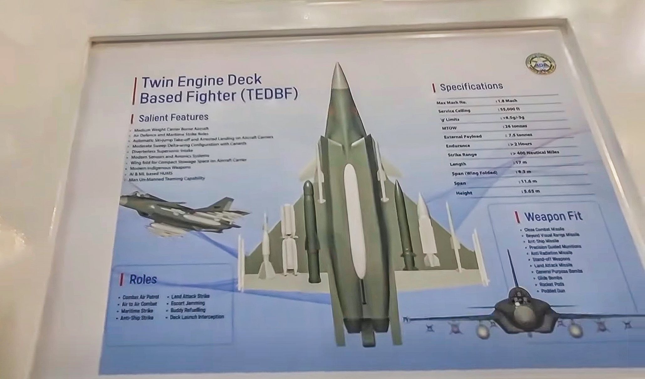

What is the comparable payload capacity of F-18E/F and Rafale-M?
Posts: 22022
hgupta wrote: 06 Sep 2023 22:44 What is the comparable payload capacity of F-18E/F and Rafale-M?
Rafale M (https://www.dassault-aviation.com/en/de ... d-weapons/)
With its 10-tonne empty weight, the Rafale is fitted with 14 hard points (13 on the Rafale M). Five of them are capable of carrying heavy ordnance or drop tanks. Total external load capacity is more than nine tonnes (20,000 lbs.).
F-18SH (https://en.wikipedia.org/wiki/Boeing_F/ ... F/A-18E/F)
11 (2× wingtips, 6× under-wing, and 3× under-fuselage) with a capacity of Max payload: 17,750 lb (8,050 kg). Carrier bringback payload: F/A-18E: 9,900 lb (4,491 kg), F/A-18F: 9,000 lb (4,082 kg)[245], with provisions to carry combinations of:

Rakesh wrote: 06 Sep 2023 22:49
If our bird can carry 9 tons and bring back 4.5 tons then it’s awesome and beat out any contemporary bird.

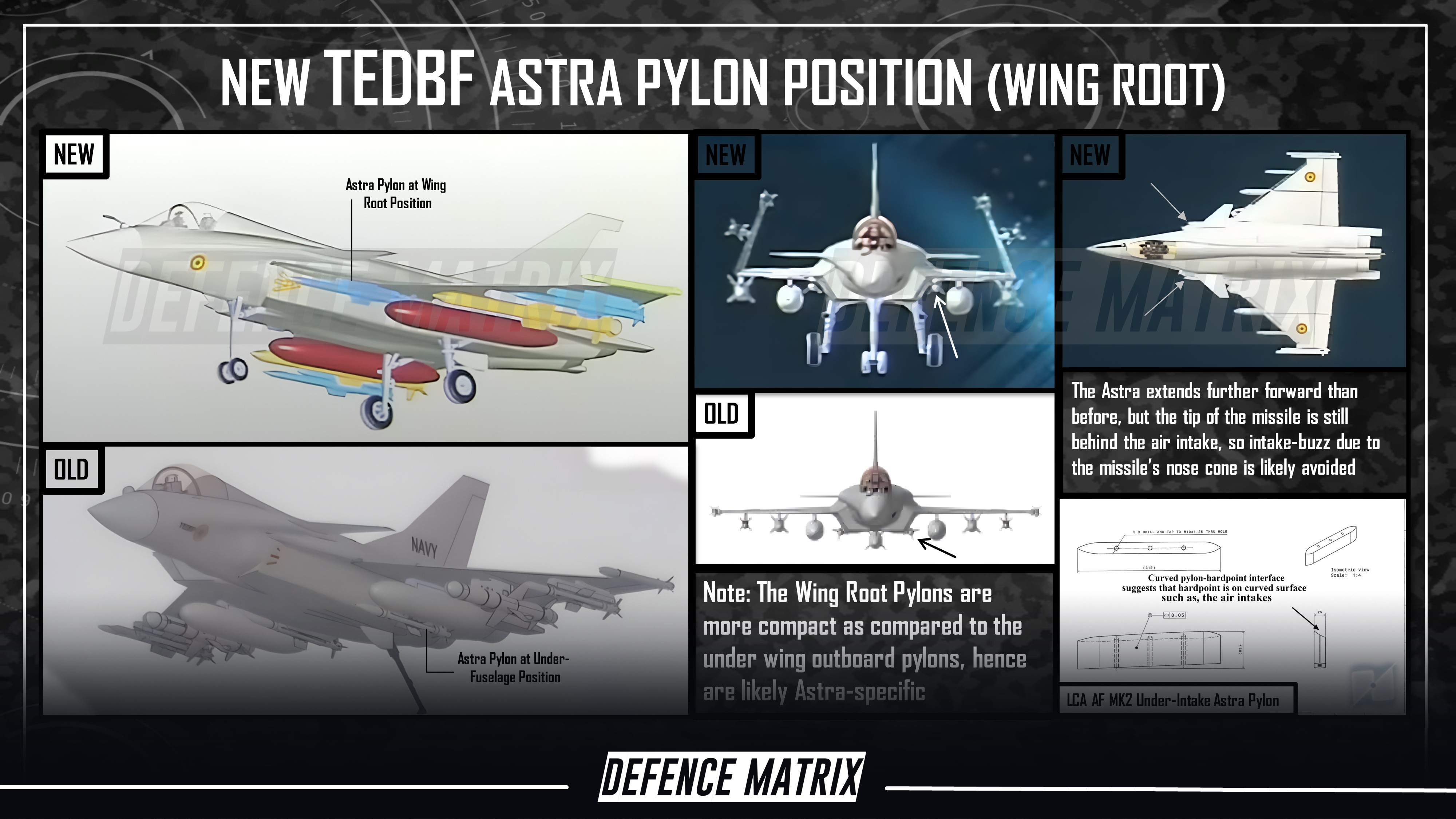

The latest (as per Defence Matrix on Twitter, Oct 2023) config of the TEDBF. What a looker!
https://x.com/Defencematrix1/status/171 ... 71064?s=20 ---> Update Regarding TEDBF Hardware Configuration
The latest visuals (Oct 2023) of the TEDBF show a change in the hardpoint configuration. The Astra pylons, which were previously located under the fuselage, have been shifted to the wing root position.
As is evident in the visuals, these pylons are more compact (but NOT semi-recessed) than the outboard pylons which are also carrying the Astra, which may indicate that the wing root pylons are specific to the Astra (similar to the under-intake Astra-specific pylons of the LCA AF MK2).
Now, the question is, what happens to the previous under fuselage hardpoint location? Has it been completely removed, or is it now free for other stores (for example, self-protection jammer pods)?

The TEDBF Project Director Dr Amitabh Saraf candidly stated that the TEDBF has a "similar concept" as the Rafale. But whereas the shape appears similar, everything else is designed at ADA and is indigenous.
Salient points from his talk at the CSIR Foundation Day 2023:
- Similar concept as the Rafale but completely designed here in India itself.
- TEDBF's wing sweeps are different, the canards are different, the shape is similar as the Rafale, but the design is completely our own.
- Diverterless Supersonic Intakes (DSI), 2 X GE F-414 engines, advanced sensors and avionics systems, wing fold will be added which Rafale doesn't have which will cause problems for the Rafale when it comes to carrier stowage.
- TEDBF is designed to operate from both INS Vikrant as well as INS Vikramaditya
- Now in the phase of obtaining CCS sanction
- Navy is very keen on the TEDBF
- Timelines- First Flight - 2028 and Induction into service - 2032.

TEDBF spec sheet from the Dubai Air Show.
https://x.com/officialTatya_1/status/17 ... 23569?s=20 --->
