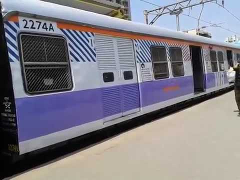

I was referring to these rakes, which looks similar to Siemens, but have middle door closed in four coaches, as the part of EMU is located there.
http://i.ytimg.com/vi/Dufjcv_hU7o/0.jpg - BEML rake
http://i.ytimg.com/vi/SN6IZy5Ew58/0.jpg - Semiens rake.
Kolkata suburban system has these rakes http://www.skyscrapercity.com/showpost. ... count=1153 , which the author believes should be provided for Mumbai as well.

That is not bad looking at all. Besides there are doors implies A/C too. Why allow people to hang out with no doors. It almost looks like the Delhi metro coaches.

And that photo is the new Kolkata rake, isn't it? Looks good. As for closing doors, there is a YT video of a train with automatic closing door under trial in Mumbai. But it will work only when coupled with AC, or too much crowd will only result in even more suffocating travel. They can perhaps implement it in non peak hour ops or the first class to begin with.
