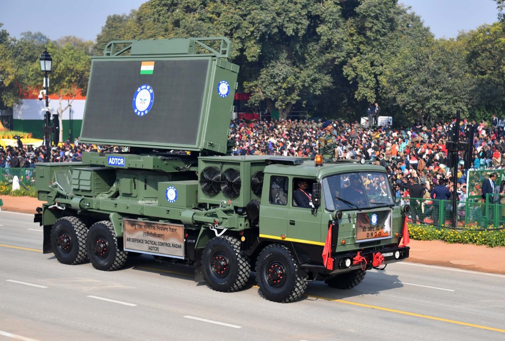

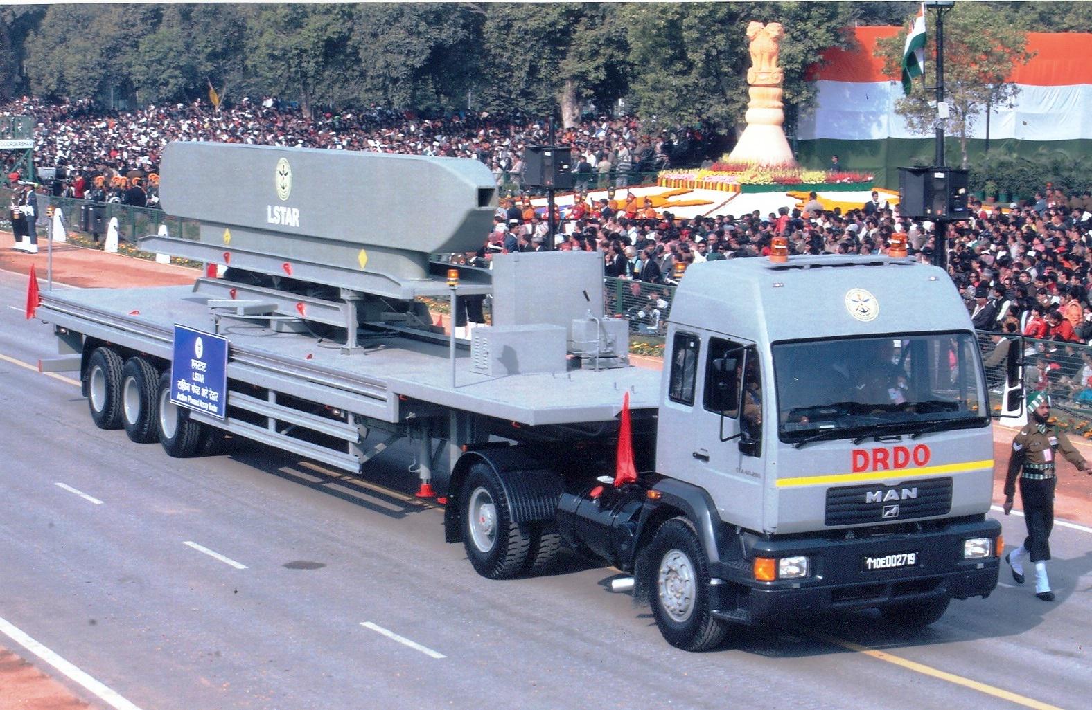

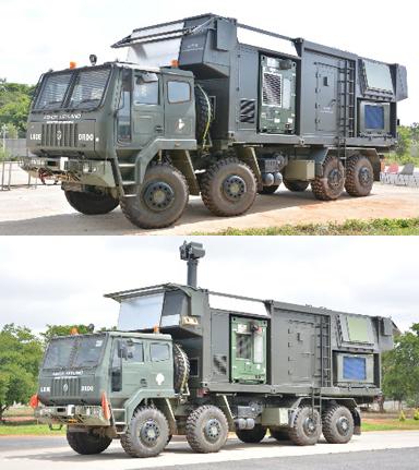

https://twitter.com/lca_tejas_/status/1 ... 17602?s=20 ---> 1. Air Defence Tactical Control Radar (ADTCR)

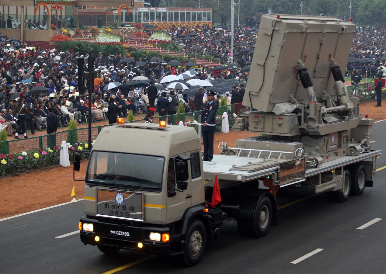

https://twitter.com/lca_tejas_/status/1 ... 71298?s=20 ---> ARUDHRA Medium Power Radar

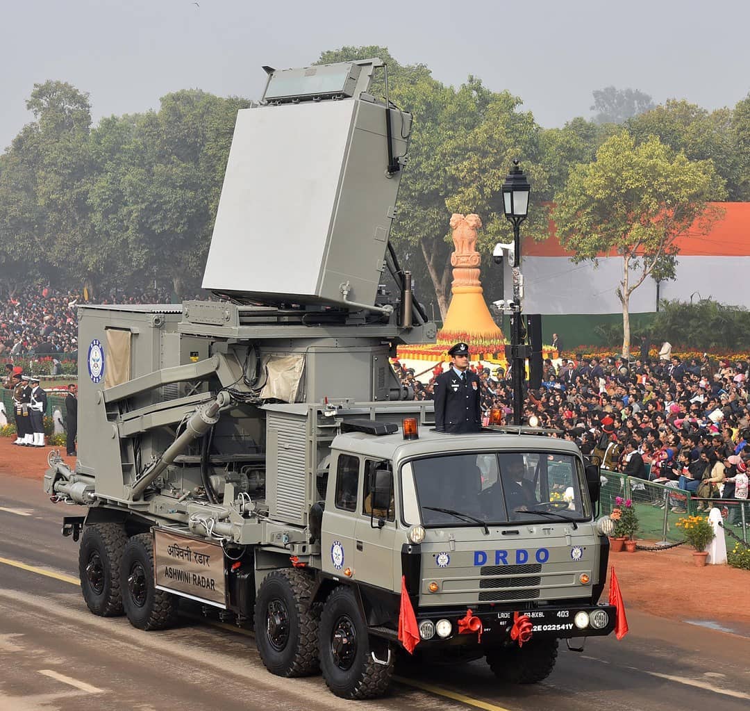

https://twitter.com/lca_tejas_/status/1 ... 63426?s=20 ---> Ashwini Low Level Transportable Radar (LLTR)

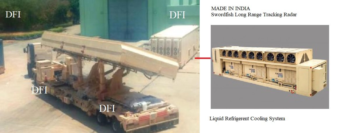

https://twitter.com/lca_tejas_/status/1 ... 83969?s=20 ---> Swordfish Long Range Tracking Radar
https://twitter.com/lca_tejas_/status/1 ... 20642?s=20 ---> Rajendra multi-function electronically scanned phased array radar.
https://twitter.com/lca_tejas_/status/1 ... 94496?s=20 ---> 3D Medium Range Surveillance Radar (Rohini)
https://twitter.com/lca_tejas_/status/1 ... 17665?s=20 ---> ATULYA-Air Defence Fire Control Radar
https://twitter.com/lca_tejas_/status/1 ... 57155?s=20 ---> Radar for Ground based SAM systems
https://twitter.com/lca_tejas_/status/1 ... 29954?s=20 ---> Tactical Control Radar
https://twitter.com/lca_tejas_/status/1 ... 83365?s=20 ---> INDRA-Indian Doppler Radar Mk 1 & 2
https://twitter.com/lca_tejas_/status/1 ... 03776?s=20 ---> LSTAR-Long range Solid state ACTIVE aperture array Radar (primary radar for Netra AEW&C). Used to great effect at Balakot :mrgreen:

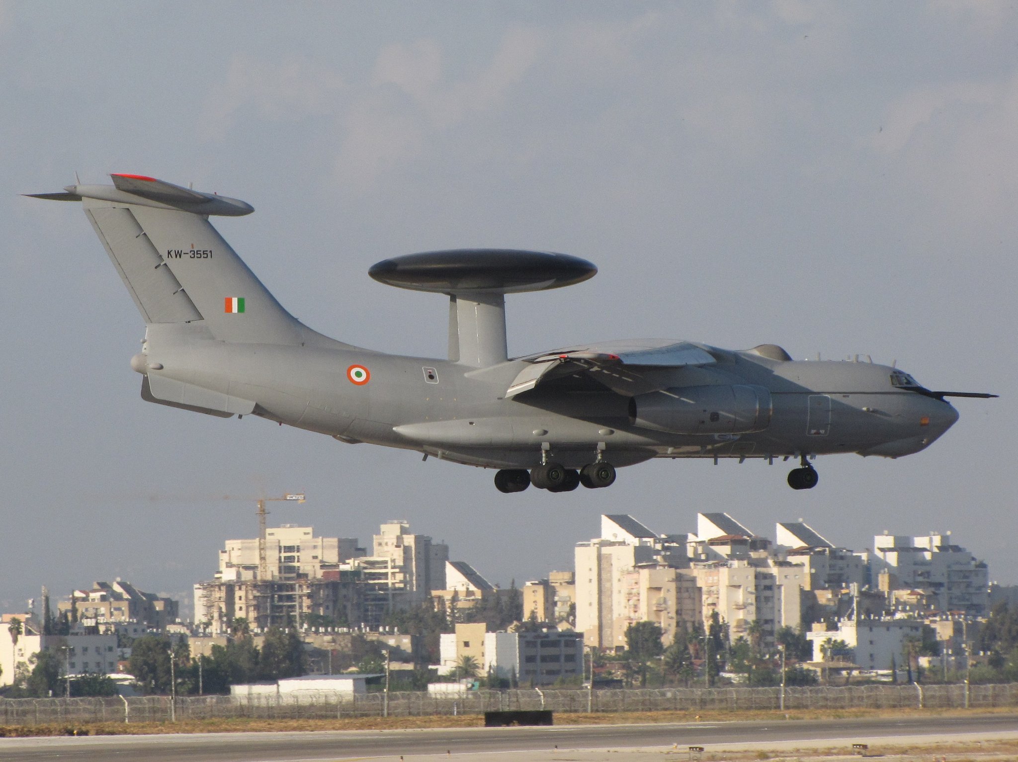

https://twitter.com/IndianDefenceRA/sta ... 92608?s=20 ---> Phalcon AWACS - 3 in service + 2 more coming.

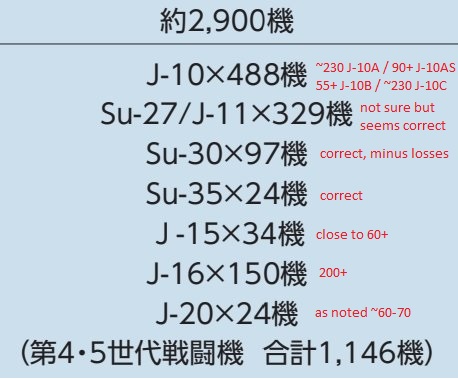

Those Chinese fighter numbers appear absurd. Andreas Rupprecht unfortunately acts more PRC than the most jingoistic PRC types themselves. His behavior on social media at times is pretty nuts. During the Indo China, stand off he was busy attacking Indians and repeating PRC propaganda verbatim, and telling Indians that they best prepare to be defeated etc. At any rate, his claims bear crosschecking. So I went and checked.
The Pentagon’s 2021 China Military Power Report quotes PRC 4th gen fighter numbers at 800 airframes out of a, total of 1800 fighters. Unlike Rupprechts amateur analysis which claims 2800+, this is Govt verified data. The US has no incentive in downplaying PLAAF airpower. If anything, the reverse.
The unclassified China report has generally mentioned "more than 800" for the Chinese 4 gen fleet for a number of years now. They haven't updated that for a while. They don't go into exact numbers in the open report but it is probably in the 800-1000 range given losses, retirements, trainer variants and what not. Annual build rates for J-10, Flanker clones, and now increasingly J-20 are more important to look at.
Agree about it being 800-1000, or even more in the worst case but about 800 seems more accurate. Seems the most Conservative and hence should be the baseline. Plus, they've updated the missile data periodically.
Even if it was more than 800 but not 1800, it clearly doesn't match Rupprechts estimate of 2876 4th and above gen fighters.
It was all the 1800, the report would have mentioned it as such. The build rates required to reach 2876 4th/+ Gen fighters would have to be world leading, and whhy would the US hide them. US analysts would have to be phenomenally incompetent to miss a build up of this magnitude and I doubt it.
So I went and checked again.
The Pentagon's report for 2019 mentions about 600 4th generation fighters of about 2000 total combat aircraft (of all kinds not just fighters). In short, they have added 100 to 250 fighters a year by 2021 using that metric (200-500 additional airframes by 2021). One can quibble about serviceability metrics etc if the vast majority use WS series engines.
2020 says over 800 of more than 1500 operational fighters.
Anyhow Rupprechts numbers appear absurd. The Chinese build rate is impressive - adding 5 squadron eqvts a year, at even the lower threshold (800 fighters by 2021), but it's not at the overall numbers projected of 2900 fighters etc.
At any rate India can't be complacent or dismiss the IAFs ask for 42 squadrons, to merely get back to the numbers it once had.
A mere 5-10 squadron increase would get us a 100 to a better 200 additional aircraft over the current 540-600 airframes in service and restore us to what levels we once had a decade back. A tough ask given the number of aircraft retirals we'd be facing.
These would need to face a significant PLAAF and PAF fighter fleet.
The PLAAF trend is clear.
2019: 600, 4th and above gen fighters of 2000 total combat aircraft (excluding transports)
800+, of 1500 total fighters
800 to 1100, of 1800 total fighters
India can't be complacent even given PRCs well known issues with quality control.

Karan M wrote:Those Chinese fighter numbers appear absurd. Andreas Rupprecht unfortunately acts more PRC than the most jingoistic PRC types themselves. His behavior on social media at times is pretty nuts. During the Indo China, stand off he was busy attacking Indians and repeating PRC propaganda verbatim, and telling Indians that they best prepare to be defeated etc. At any rate, his claims bear crosschecking. So I went and checked.
That Andreas Ruppercht twitter shot shows a total of 1146 Flanker/Flanker clones/J10s/J20s. The rest which are not specified are older F-7s etc. 1146 is not far removed from 800+ of a few years ago when you consider production per year of various types over the last few years.
Another event to look forward to is the supposed fly past of 25 J-10Cs which the PAF is supposed to get sometime in March. If they actually show 25 of them flying past, then you do know that at least as far as the J-10C is concerned, production numbers are healthy.
Even considering what you said, his numbers are adding up to 1335, 4 Gen and above platforms. The original estimate itself (1146) is on the high side considering its part of an estimate which is adding up to 2900 fighter airframes compared to the US Congressional submitted numbers of 1800 fighters of which 4Gen and above are 800+. I used 1100 as a worst case scenario assuming the +300 airframes from 1500 to 1800 were all 4 Gen plus fighters.
The original Chinese unsoyrced claim says 1146 4 and 4.5 Gen whereas a bunch of those J-10s and Flankers are firmly 4 Gen. So a discrepancy there too. Rupprecht adds another 189 airframes to that. In short he's literally 40-50% above the 800-900 US Congressional estimate.
Plus we can't state that merely because 25 J-20Cs are flown indicates anything but PR. It says little but the fact that that number of aircraft were available. If IAF did an elephant walk of xx Rafales, all it means is that number of Rafales were available at that point of time. Not much about future orders etc.
The limiting factor of all their ambitious programs is propulsion. If they've cracked that, at high MTBO per unit, then our challenges become far worse than they already are.
So far we've seen them put up 150 aircraft formations vs ROC every 3-4 days indicating that's the amount of surge they can handle at a regular (not wartime) tempo. Thats pretty low given the number of sorties even a MiG-21 would pull in a month. Indicates the fighters they do deploy require heavy maintenance per flight hour.
At any rate - the IAF needs more airframes and the GOI needs to commit to that. Its the trend which is a concern. Even if they have 1146 aircraft and only say 700 are available (60% serviceability, sustained, a very optimistic estimate despite their QC issues) and half of those are deployed vs the IAF, say 300, we can't forget they are complemented by the formidable PLARF whose salvos will be disrupting IAF ops.
