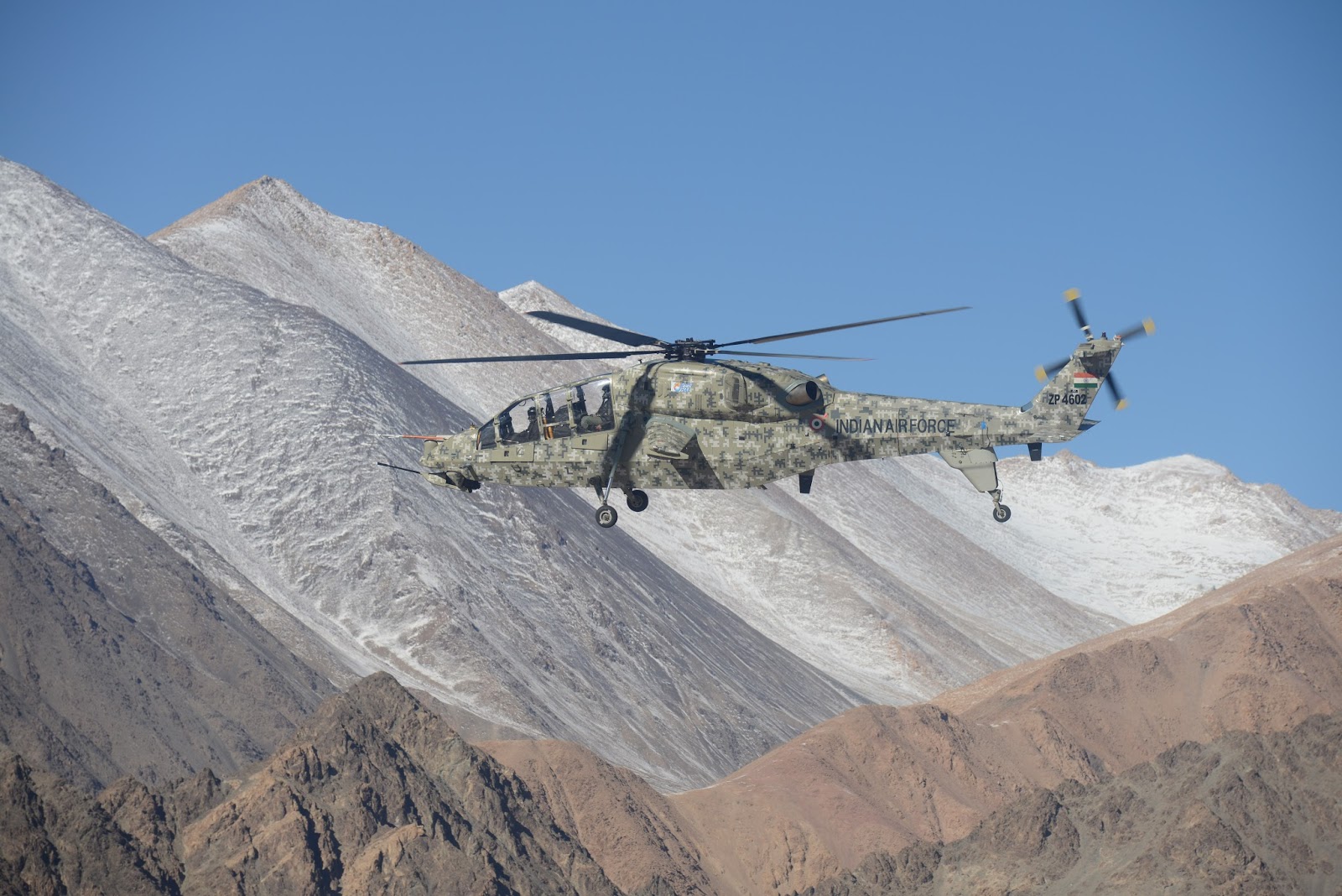

TD-3 seems to have a M2K type camouflage. Perhaps, advertising an IAF variant.
More like the russian arctic paint scheme.JTull wrote:TD-3 seems to have a M2K type camouflage. Perhaps, advertising an IAF variant.

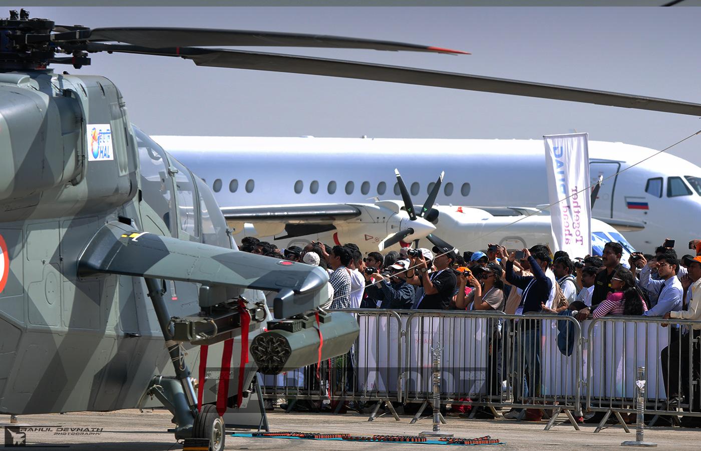

Anantha Krishnan M @writetake
#PlaneCarnival #SkyParty | Pic: Rahul Devnath-10 @Oneindia
Quality wise, LCH TD3 body fit and finish definitely Euro-esque.
Finally a made in india weapon looks like a plastic toy
compared to this, TD1 is definitely more 'soviet' in fit and finish.

Wow. Nice Pic
That camo will make it very very difficult to see the bird against the background of the mountains
This sleek predator will strike terror in those unforgiving ranges... one day soon

LCH completes cold trials
The Light Combat Helicopter that is under development has completed the mandatory cold weather trials at Air Force Station, Leh. Its performance has been satisfactory, its developer Hindustan Aeronautics Ltd said on Monday.
The second technology demonstrator prototype LCH TD2 was taken from Bangalore to Leh and tested for its performance in extreme cold weather as part of its overall assessment.
HAL Chairman T.Suvarna Raju said the engine starts were satisfactory at temperature of minus 18 degrees Celsius at 4.1 km. Flights were also carried out to assess the helicopter's high altitude performance and low speed handling. The trials covered engine starts with internal batteries after overnight cold soak at altitudes of 3 km and 4.1 km.
