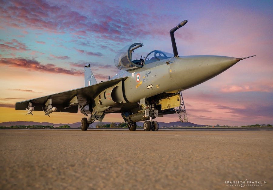

Post by ashishvikas »
Armed and ready to go !
https://twitter.com/Praneethfrank/statu ... yqEZQ&s=19
Tejas armed with Derby
