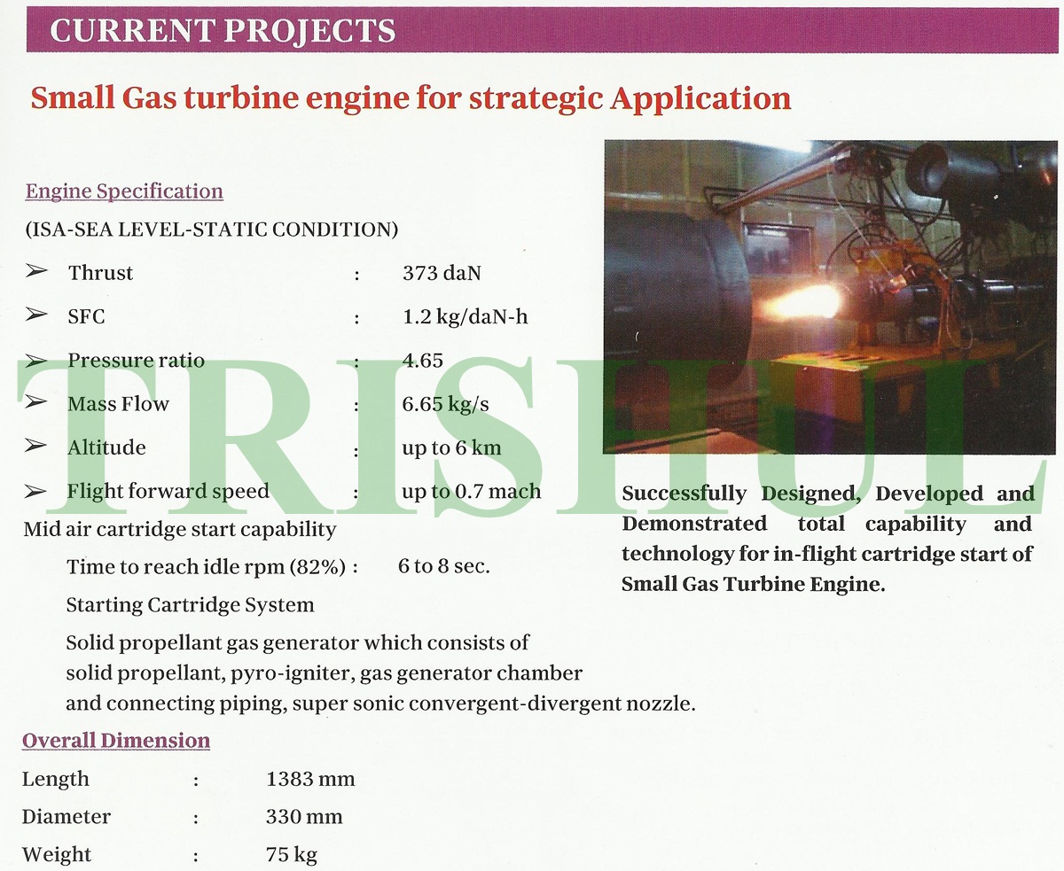

We need to break our dependence on rus for the nirbhay engine. Sooner or later i feel unkil will come down hard on rus and they will cave in and cut supply. Being a strategic weapon we need to make one such engine ourselves asap.
Unkil does not like anyone making tomahawk clones. Only cheen and french have developed or developing comparable range weapons.
Re: Indian Missiles and Munitions Discussion
The are projects but far from being a product the nirbhay can use. We need to get better at converting projects and protos into mass manufactureable and reliable product all across the board. Just info boards at defexpo doesnt mean its ready for prime time.
For now it seems we purchasd 200 saturn engines.
if we are smart and find those engines working well, we should get license manufacture and keep a stock 2000 while Norbhay is being developed and simultanously work on them.

Ukraine could also have transferred some engines and production tech. Cheen is very chummy with ukraine.
It is a joke that we can't make RR Orpheus type engine for our UAVS projects.
We do not have culture to do originall thinking but just addicted to CKD and screw driver methods.
If only we had the fore sight we would have developed the Gnat Engine as our basic design then upgrade to all exotic SC blah blah blah.
IIT Kharagpur IIT madras have had aeronautical engineering depts and thermal turbo machinery and Gas turbine courses and graduates for the last 60 years approx but still waiting for Russians damn it we buy Swiss propeller trainers so much for engineering pool

Turbo-jet or turbo-fan?
1000km range would be with turbo fan due to low sfc.
