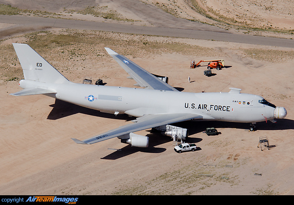

Wasn't the great khan working on a 747 mounted airborne laser ABM sytem? Don't know if that system got cancelled.

nachiket wrote:Wasn't the great khan working on a 747 mounted airborne laser ABM sytem? Don't know if that system got cancelled.
The Air-Borne Laser has been mothballed
http://www.airteamimages.com/pics/145/145031_800.jpg
However, we might be developing something more along the lines of the solid-state, terrestrial, JHPSSL. According to this link, a 100 KW laser could require a 1 MW power supply.
