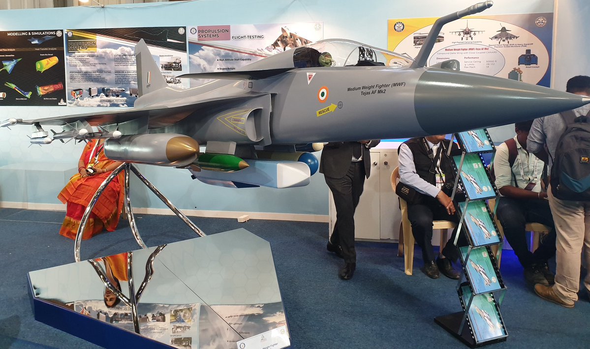

I’m in love with this design!SaiK wrote:Video
We’re live first & exclusive with India’s new canard concept — the Medium Weight Fighter (the rechristened LCA Mk.2) https://t.co/2lH3yKiy2u

Tejas Mk2 is done with inputs from the IAF. There are three basic points that IAF wanted from Mk2:
1. Better transonic and supersonic performance
2. Better STR
3. Better endurance payload
You cannot have all of that with just a 10% increase in thrust. Hence, such an elaborate change. By the way, MWF is very easy on my eye.
1. With the canard, elongated and reshaped body, the plane will have much lower wave drag. Even with the larger body, it will have a drag reduction of about 10-15%. You can see that translated at the top end itself.More details in the write up.
2. The Canard can also allow much better L/D ratio. Again coupled with better thrust, it will lead to significantly better STR. Actually ITR may also go up because they have done lots of tweaks to get better CnBeta performance (the limiter on LCA Mk1).
3. Although they have increased the payload carrying capacity, they have done it judiciously. The wingtips essentially come free. They can carry 11% more fuel externally than the current tanks at reduced drag! In other words, Mk1 with two 1200 ltr tanks has almost the same drag as Mk2 with two 1320 ltr tanks and about 1000 ltr more fuel carried internally. That's huge.
Of course, in the max load configuration, it is a bomb truck. But that is fine with IAF. I don't think they are looking for swing role. They want a lightweight multirole fighter which is nimble in the A2A role, and a can carry a lot of load in the A2G role.

Looks like the Tejas Mk2 model got a weapon load out. Please drag & drop the picture into a new browser window for larger view.
The model is different from yesterday's post (viewtopic.php?f=3&t=7636&p=2322362#p2322362), which had no weapons.
I see SCALP in the centreline, which ties in with Saurav Jha's tweet in the post above. Four air-to-air missiles on the right wing, so a total air-to-air missile load out of 8 missiles. Very Nice!
https://twitter.com/DECATRIX/status/1098200767230406656 ---> Finally the scaled model of the Medium Combat Aircraft revealed. Very similar to the Mk I. Grown larger, with canards, projected refuelling probe, dual rack pylons and wing tip pylons.
https://twitter.com/DutchAviaPhoto/stat ... 0750547968 ---> Tejas Mk2 gets canards, big payload boost.

The extra length changed the fighter’s center of gravity, requiring the addition of a forward lifting surface. The ADA looked at a number of options, including leading edge extensions, but finally decided on canards, which also help with maneuverability. The new aircraft also sees improvements made to the fighter’s delta wing.
“The forward canards help in other areas too,” says the official.
