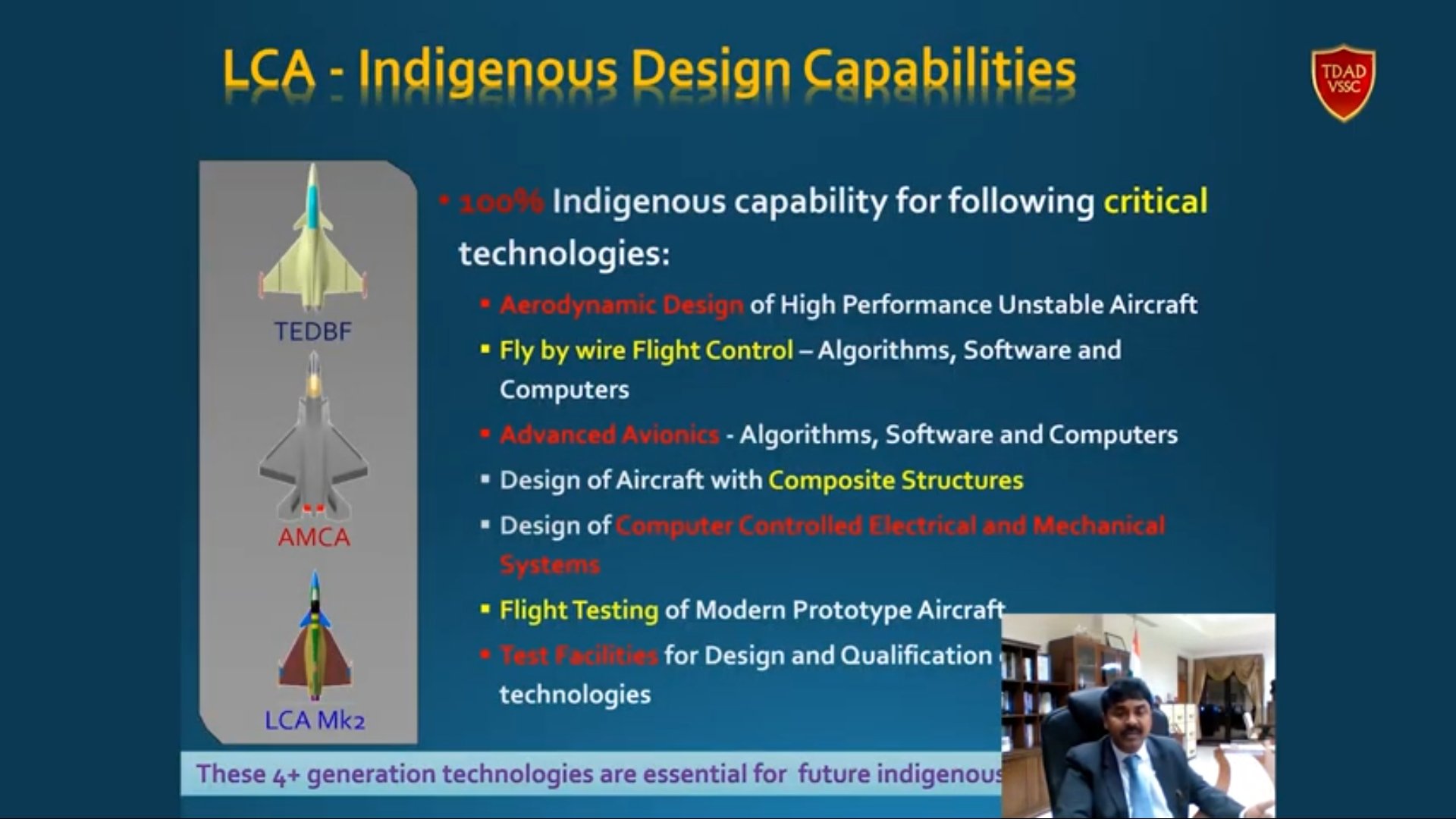

As presented by Dr Girish Deodhare- Tejas Mk2 (MWF) first prototype planned to be rolled out by July 2022. First flight by early 2023. This is the most eagerly awaited fighter as far as I'm personally concerned. Set to form sizeable bulk of IAF fleet.

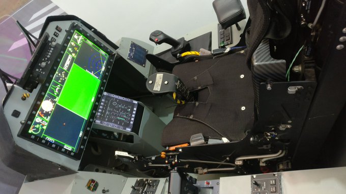

Human-Engineering evaluations of its cockpit workspace. Side-Stick...
https://twitter.com/TejForTweet/status/ ... 4799463424
I think new pilots will get easily habitual to this. I can sense how strange this must be for you Smiling face with open mouth and smiling eyes. I have never flown anything but it was weird for me as well during the Expo.
https://twitter.com/hvtiaf/status/1314039654136471552
Mk-2 cockpit
...quite different from Mk-1

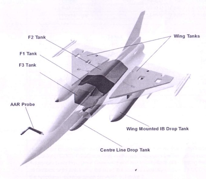

More details coming out. 3388 kg of internal fuel. 7148 kg of total fuel. The things that make me chuckle: IB Drop tank capacity is 1360 kgs(not ltrs). And FINALLY, an oval centerline DT carrying 1040 kg of fuel. Bolo, kahaan ghumne jaana hai?
These are really close to Mirage 2000's DTs.
3388kg, that's a 37.8% increase in internal fuel over Tejas's 2458 kg.
In the same ballpark as a F-16 (without EFT): 3175 kg (https://www.af.mil/About-Us/Fact-Sheets ... ng-falcon/)
Still lower than that on the Mirage 2000 which had 3950 (https://fas.org/man/dod-101/sys/ac/row/mirage-2000.htm)
However, its dry thrust SFC is 0.9 (lbs of fuel/lb of thrust) and that of the GFC
F414 supposedly
F414-GE-400
(MIL) 14,700lbs @ 0.840 lb/HR/lb st
(MAX) 22,000lbs @ 1.850 lb/HR/lb st
Wonder why they didn't add a bit more fuel. Perhaps focus is on DT which can anyhow be dropped before combat.

From the HAL tyre tender MTOW is 18200 kg for Tejas mk2.
From Defexpo 2020 empty weight is 7850 kg.
Estimates
IB fuel tank full weight with 1360 kg fuel approx is 1500 kg
Central fuel tank with 1040kg full weight 1150kg.
Internal fuel roughly 3400kg.
18200kg -2*1500kg-1150kg-3400kg-7850kg=2800kg
Taking 800kg as same as Tejas mk1 of 2 CCM and other misc.
Full fuel fraction at MTOW is 39.27%
Empty weight fraction at MTOW is 43%.
We get remaining external payload of 2000kg which 2 mid board pylons can carry if rated to 1000 kg each.
Clean take of weight=12050kg.
External payload=6150kg.
Big payload for the size of the aircraft.

Picture is from the HAL Tender link that I have posted.
Can post the numbers. If any number that I have estimated is incorrect IR should know.
Normal take of weight 17500kg.
MTOW 18200kg.
Internal fuel 3388 kg
External fuel 3760 kg
Total fuel 7148 kg.
The above figures can go into page 1.
Clean take off weight and external payload need confirmation.

sankum wrote: Clean take of weight=12050kg.
Hmm. Mtow: 18500 - 4000kg (internal fuel and fluids), 6500 payload + pylons ~ 8000kg empty weight.
sankum
Posts: 1150
Joined: 20 Dec 2004 21:45
Post by sankum »
Roughly it is like below
Empty weight 7850 kg
Misc 800kg
Sum of above Clean take off weight 12050 kg
External Pay load 6150 kg
Total sum MTOW 18200 kg
Misc 800 kg is as below
Pilot wt 100kg
Cannon ammo + chaff / flare 100kg
2 CCM 200kg
Pylons 400 kg
Posts: 23146
sankum wrote:Picture is from the HAL Tender link that I have posted.
Sankum-ji, I have updated page 1.
Please check and IR also check and edit, if anything is wrong.
The fuel numbers are correct.
The MTOW I would still say is 17.5 tons. The 18.2 tons I think is for contingency.
Mk2/MWF will easily outrange Mk2. Higher fuel fraction and significantly lower SFC can lead to only one thing. I would say 300-500 kms more in range.

Indranil wrote:More details coming out. 3388 kg of internal fuel. 7148 kg of total fuel. The things that make me chuckle: IB Drop tank capacity is 1360 kgs(not ltrs). And FINALLY, an oval centerline DT carrying 1040 kg of fuel. Bolo, kahaan ghumne jaana hai?
Nice. Compares well with the 3400 kgs of internal fuel on the Gripen E and is slightly greater than that of the Mirage-2000. With IFR and OBOGS, the Tejas Mk2 will have incredible range and endurance.
