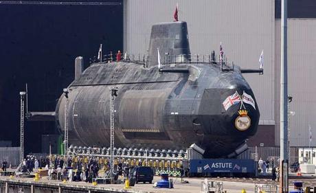

negi wrote:^ Boss in case of RU subs the torpedo tubes are right on the frontal hemisphere (anywhere from 6 or even more) in case of Akulas even the countermeasure dispensers are located in the same region (above the torpedo tubes) which means the section of the hull right after the frontal region might house the torpedo room and stowage for the countermeasures. Unkil's subs have the torpedo tubes located on either flanks so the fore section of the hull is freed up (LA class and Virginia have 12 VL tubes in that region for Tomahawk LACMs) the frontal hemisphere itself houses the spherical sonar transducer array.
What about Brit and french?
Re: INS Arihant (ATV) News and Discussion -2
anypme who uses the american style giant sphere sonar has the nose locked up and needs angled torpedo tubes behind it.
british have used their usual chankian tactics and tallboy santro design to put the thales sonar on top and torpedo tubes at the
bottom of the nose a bit behind the sonar
http://3.bp.blogspot.com/_J0gDkDskVlA/S ... 23376c.jpg
http://www.royalnavy.mod.uk/upload/pdf/ ... _image.pdf
the french as is the norm, have done the exact opposite of the british for their barracuda SSN - torps on top, sonar on bottom!
