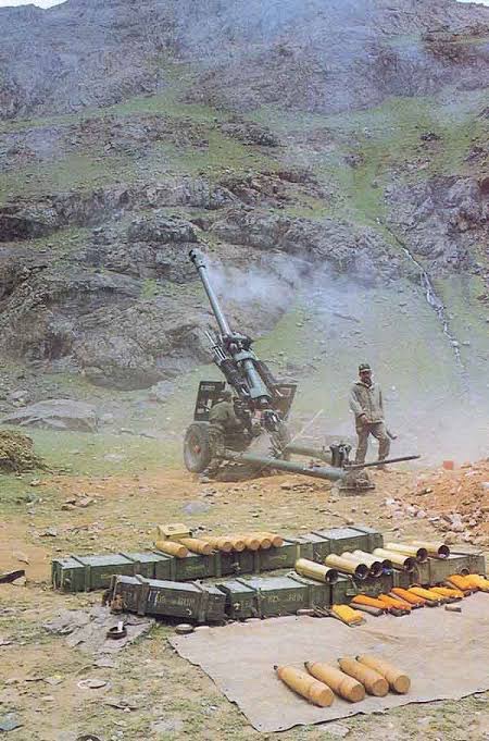

How is an old gun like FH77B so reliable when newer ones like m777 seem to be substandard?

Posts: 22038
https://twitter.com/VJSWRITER/status/15 ... sdxe97AQ4Q --->
Some of the 105mm guns of 41 Field Regt were firing 400 rounds a day. The barrels would get so hot that experienced gunners would drape the barrels with gunny bags soaked in snow melts to cool them and continue the fire offensive.
^^^ they are still used in LOC in driect fire mode to pound the paki vermin
https://www.youtube.com/watch?v=zFd5QnMJwMQ
