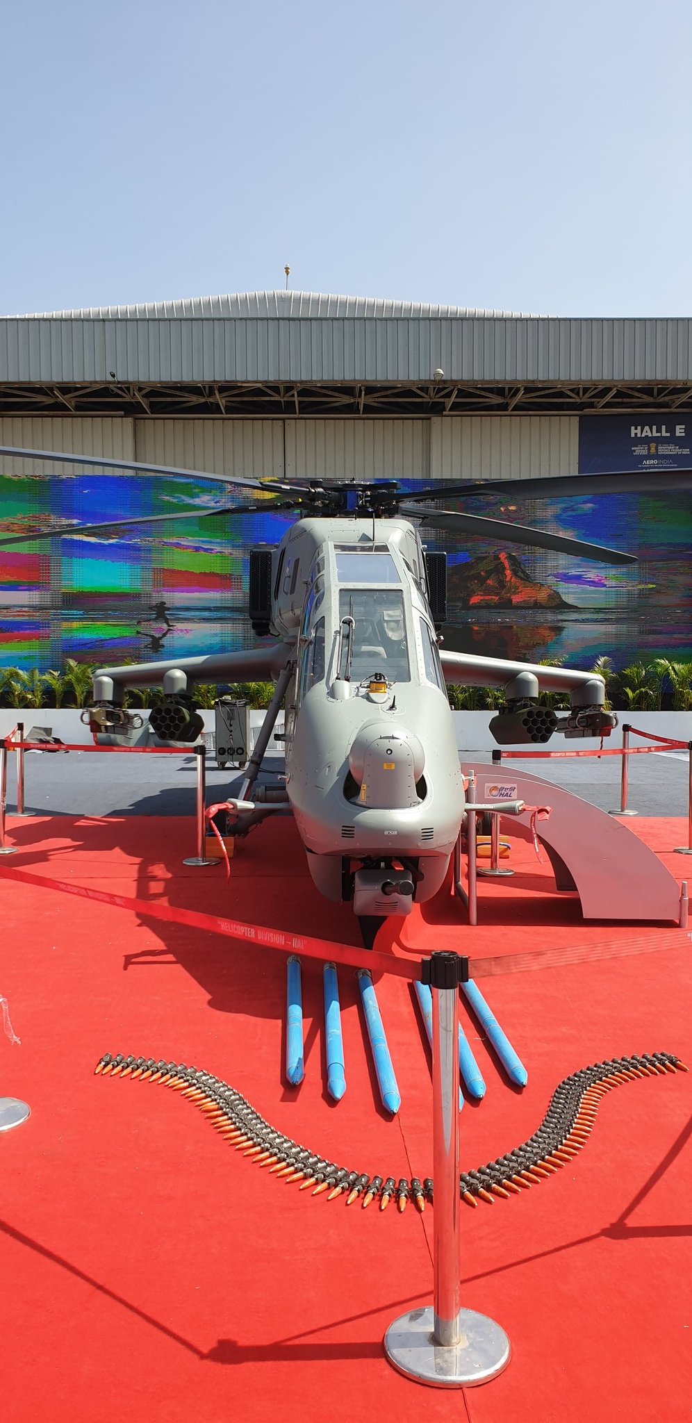

2 rocket pods + 4 mistral AAM.
2*170kg+2*55kg= 450kg
MTOW=4750kg
@4500kg service ceiling 6500m

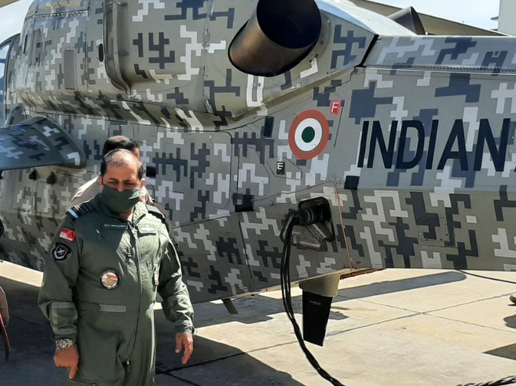

tsarkar wrote:The exhausts look modified upwards in the LSP
Sir, It seems the new exhaust setup was tested before on the TD-4 but we didn't notice it as a clear side view was not available.
John
Posts: 3447
Joined: 03 Feb 2001 12:31
Re: Light Combat Helicopter: News & Discussion: 10 August 2020
Post by John »
Sir, It seems the new exhaust setup was tested before on the TD-4 but we didnt notice it as a clear side view was not available.
I think someone spotted it and we have discussed it. Because it wasn’t a surprise to me when I saw it.

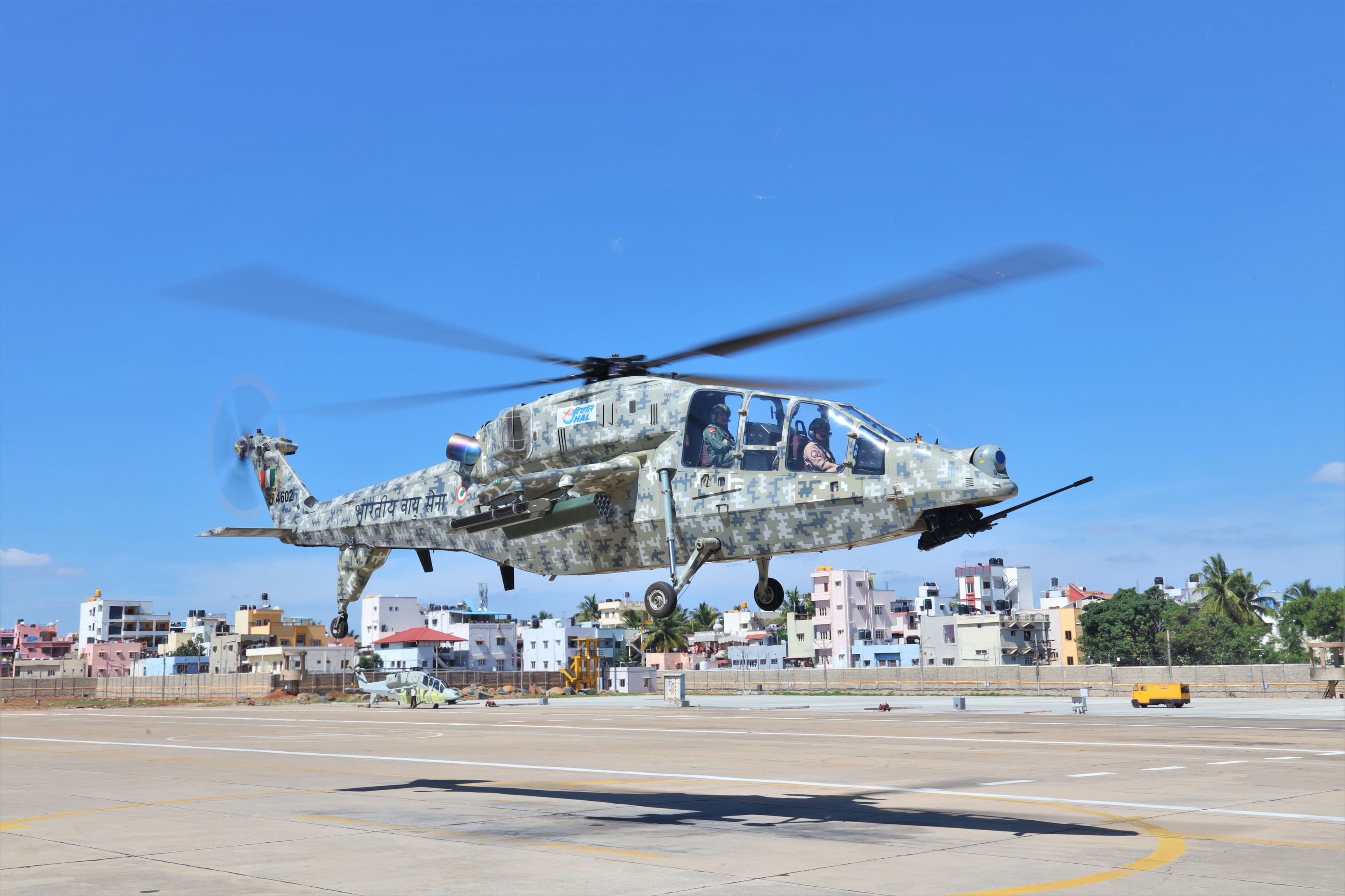

Some more pics of the above flight...

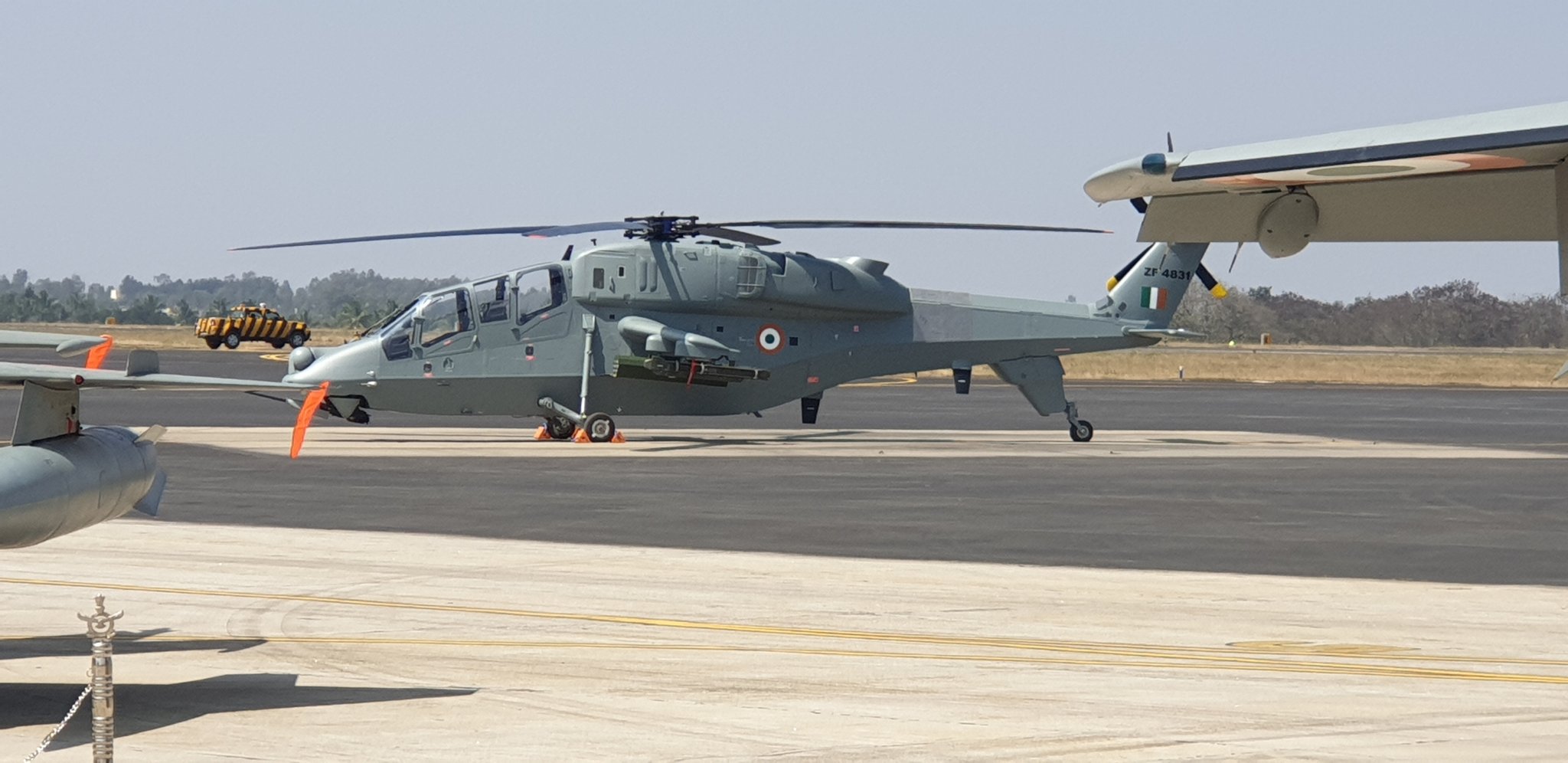

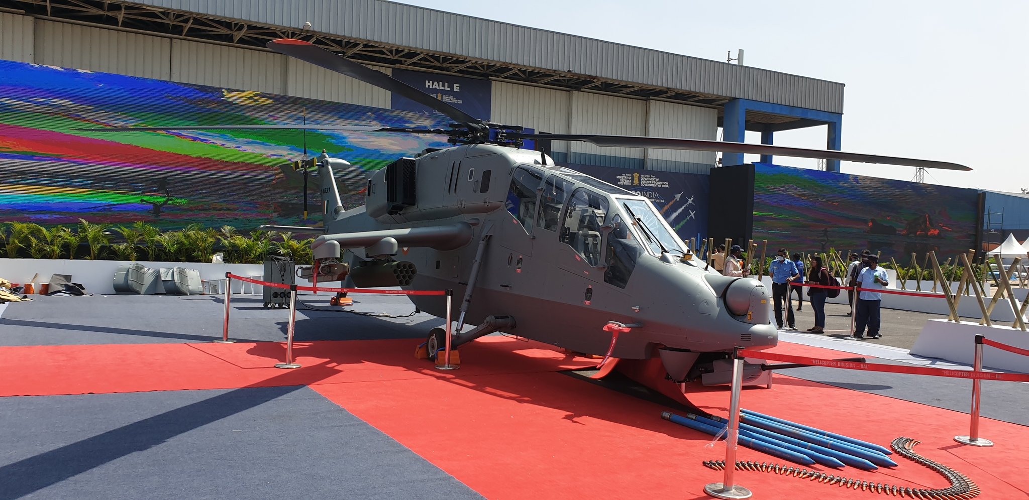

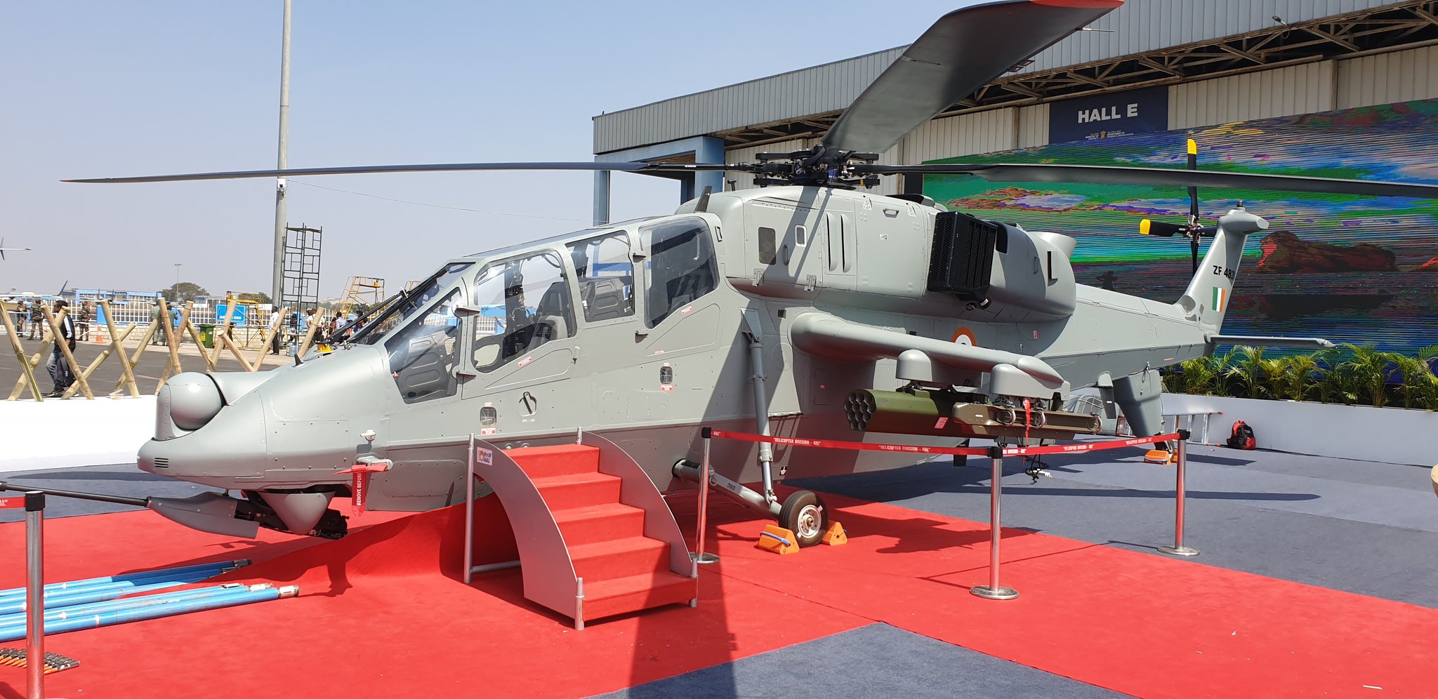

I’m guessing everyone has seen the Tipnis grey LSP-1 LCH parked at aero India by now, which is for the IAF.
Anyone know why the IA/IAF are STILL yet to spec a self protection suite for it? I mean the least they could’ve done is put the same saab SPS from Rudra on it or is this still going to happen before they hand it over? Or because it’s IOC and a LSP only they won’t have such a basic system integrated?
LCH is designed by HAL to have a DIRCM but there isn’t even a RWR on this bird, very very perplexing.

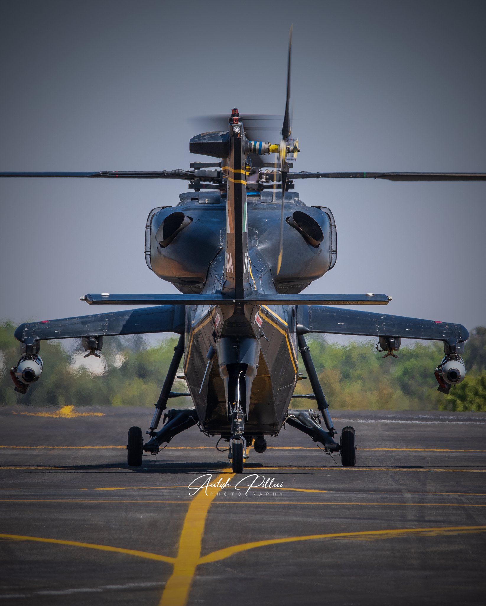

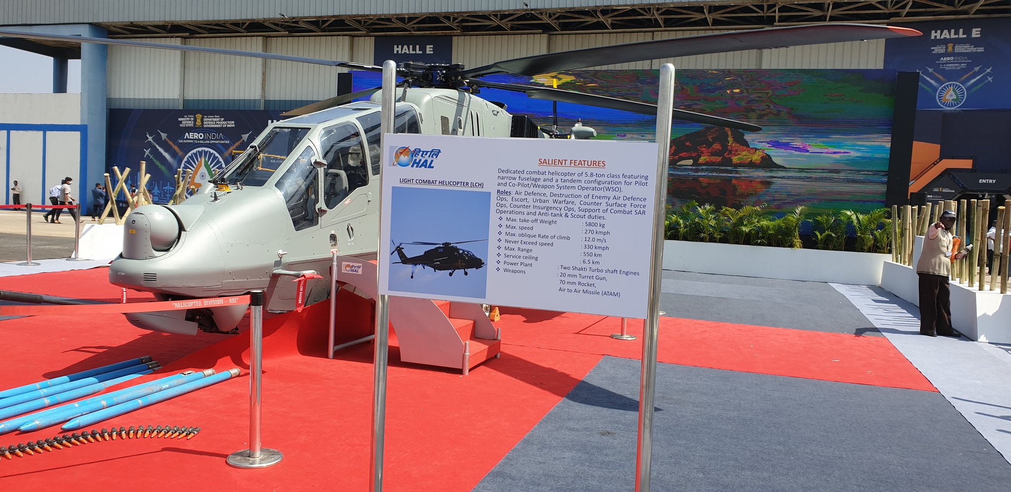

Beautiful snaps of a fantastic weapons platform. Will it be possible for those at Aero India to get good clean side profile of LCH, the LSP version? I haven't come across high resolution image that's clean.
