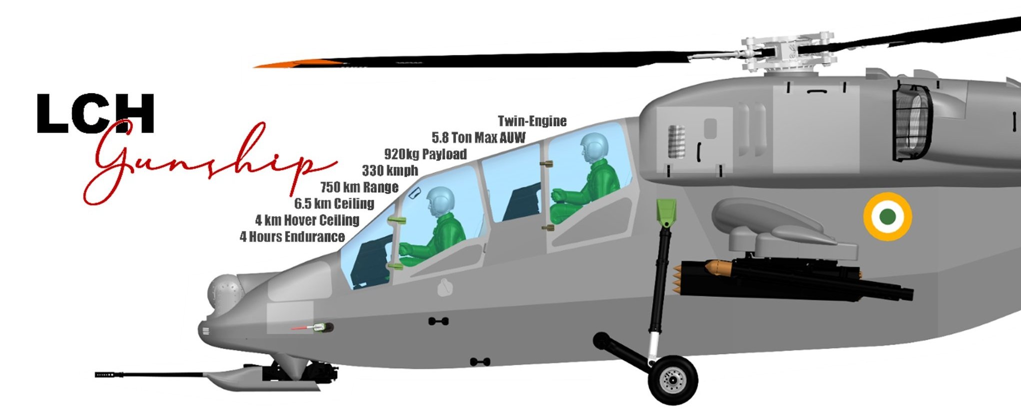

Design Specifications
Crew: Two in Tandem Seating Configuration
Length: 15.8 meters
Wingspan: 4.6 meters
Height: 4.7 meters
Main Rotor Diameter: 13.2 meters
Maximum Take Off Weight: 5,800 kg
Maximum Payload Capacity: 1,500 kg
Normal Payload Capacity: 700 kg
Engine: 2 × HAL/Turbomeca Shakti-1H1 turboshaft each producing 1,032 kW (1,384 shp), but derated to 798 kW (1,070 shp)
Performance Specifications
Maximum Speed: 269 km/h
Never Exceed Speed: 330 km/h
Range: 550 km with weapons
Endurance: 3 hours, 10 minutes
Service Ceiling: 6,500 meters
Rate of Climb: 12 meters per second

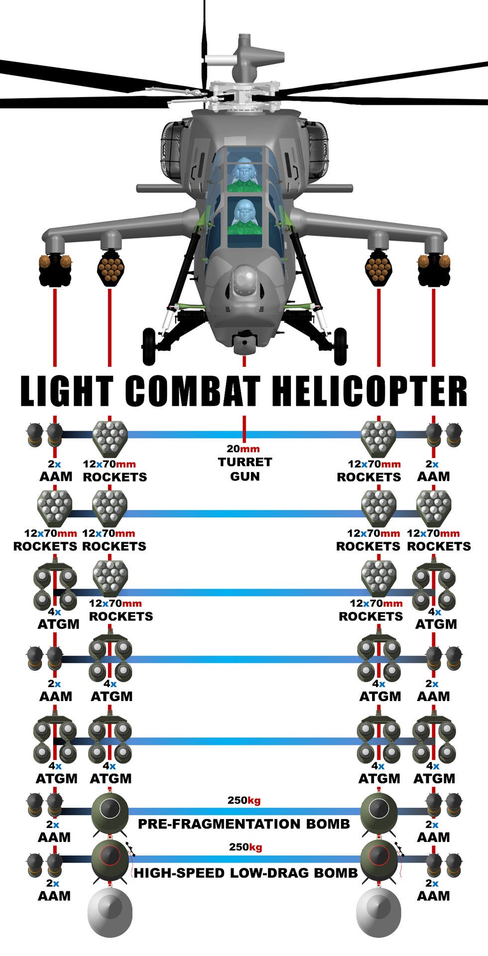

Armament
Guns: 20mm M621 cannon on Nexter THL-20 turret
Hardpoints: Four with provisions to carry combinations of:
... ... ... ... ... ... ... Rockets ---> 70mm FZ or Thales rocket pods
... ... ... ... ... ... ... Missiles ---> Two-round Mistral-2 air-to-air missiles or four-round Helina (planned)
... ... ... ... ... ... ... Bombs ---> Cluster bombs, unguided bombs or grenade launchers

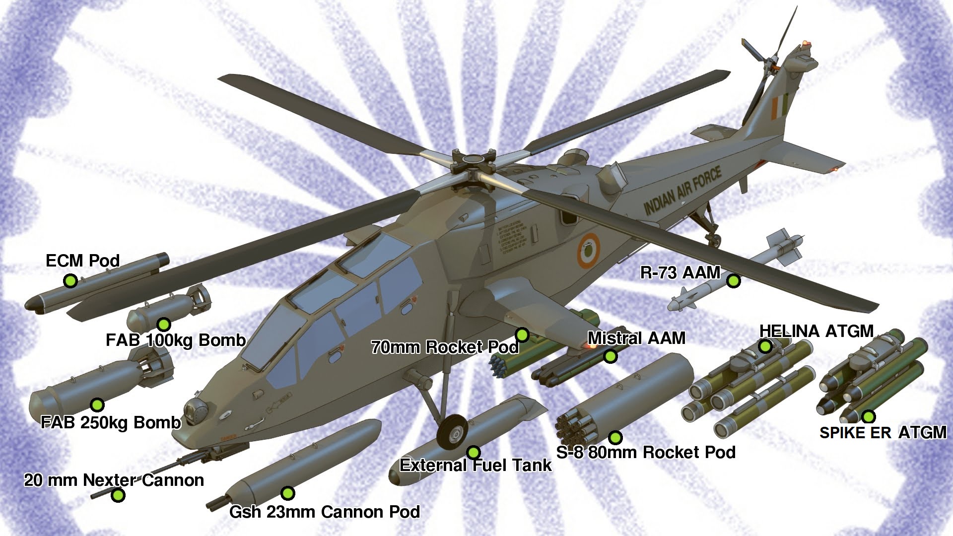

https://twitter.com/Amitraaz/status/129 ... 41728?s=20 ---> Here are the few sensors from the EW suite of HAL's LCH.
PS: Not sure about the placement of CFDs.
https://twitter.com/Amitraaz/status/129 ... 32642?s=20 ---> And this is what LCHs are capable to fire...

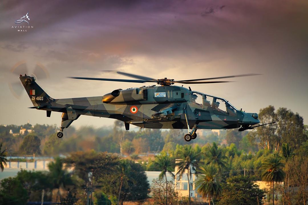

https://twitter.com/singhshwetabh71/sta ... 05249?s=20 ---> A pretty sweet pic of ZF 4603. Picture from Aviation Wall. Fun fact first two prototypes of LCH have Tail numbers starting with ZP (4601/2) as opposed to ZF (4603/4) for the latter two and Mi-17V5s also have tail numbers starting with ZP.

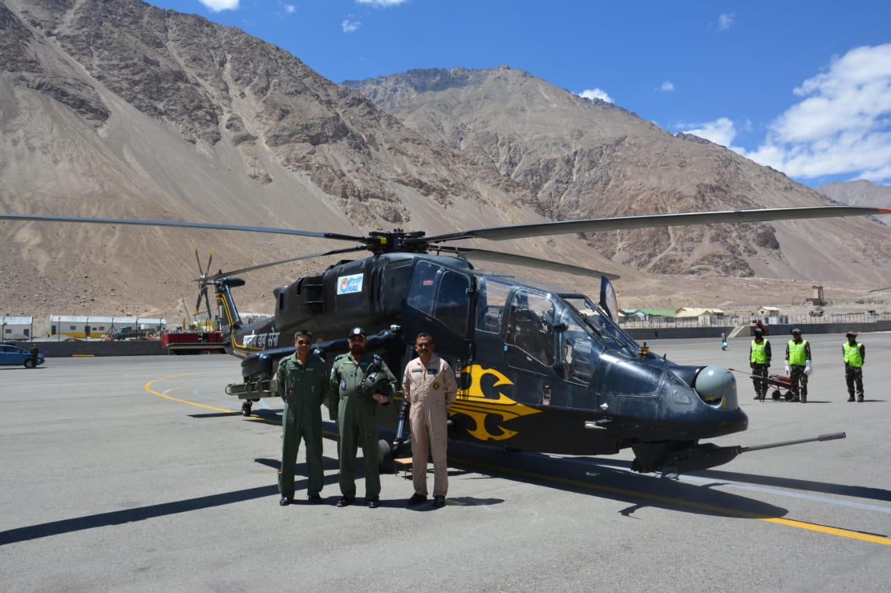

https://twitter.com/livefist/status/129 ... 27555?s=20 ---> EXCLUSIVE: India's Light Combat Helicopter deployed with IAF in Ladakh on force projection mission for a week now, flying operational patrol missions with IAF pilots to forward areas.
EXCLUSIVE: Light Combat Helicopter Deployed With IAF In Ladakh
https://www.livefistdefence.com/2020/08 ... adakh.html

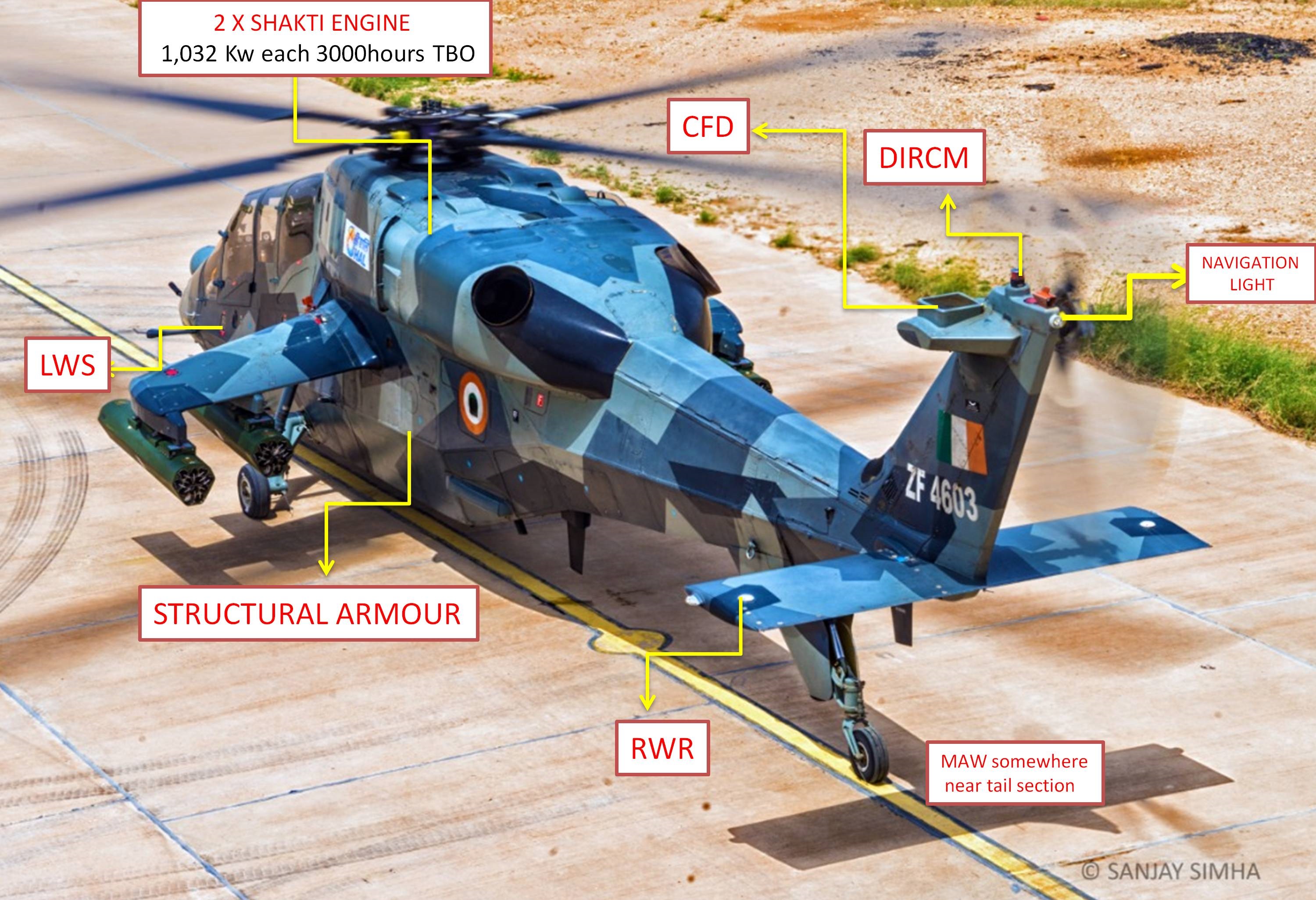

Rakesh wrote:https://twitter.com/Amitraaz/status/129 ... 41728?s=20 ---> Here are the few sensors from the EW suite of HAL's LCH.
Absolutely fake EW suite description in the photo showing with tail light shown as DIRCM :rotfl:
And the CFD, that is not the correct term, is shown firing upwards when attack helicopters face MANPAD threats from down below.
Neither Dhurv, Rudra nor LCH has any DIRCM.
LCH has not been fitted with any MAWS or LWR or CMDS
Only Rudra has the SAAB MAWS and LWR above the cockpit and CMDS under the India Roundel
Rakesh wrote:https://twitter.com/Amitraaz/status/129 ... 32642?s=20 ---> And this is what LCHs are capable to fire...
The only weapons certified on the LUH are ATAM, FZ 70 mm rockets and 20mm Nexter gun. Rest all are speculation.

https://twitter.com/HALHQBLR/status/1293420947186171904
HAL produced two Light Combat Helicopters (LCH) have been deployed for operations at high altitude (Leh sector) at short notice to support IAF missions.
If nobody here can counter this arguement , why don't our mods can remove the Avionics section in the first post , except the Elbit FLIR
I was thinking thats the major reason why IAF/IA not ready to order those LCH , while whole BRF polishing the HAL but blaming the IAF not buying it

tsarkar
I saw that Elisara PAWS on AH 64 has DIRCM, why don't HAL hesitate to buy them, as It already has Elbit FLIR , they don't have issue with the PAWS for integration, unlike the SAAB's IADS-2 on Rudra

^^^ Are we sure the IAF is not ready to order the LCH? Also, are we sure the LCH has no EW suite or no CMDS? Finally, are we sure the picture of the LCH that has been commented on (locations of various sensors, etc) is representing the the LSP or production version? Are we sure that all HAL needs to do is pop across to the nearest vendor and just buy EW stuff and bolt them on?And finally, are we sure we should be discussing and laying out every minutiae of the program on an open forum? :)

Hari Nair, Can the Hellfire be integrated on LCH/RUDRA if available?
Posts: 4594
Re: Light Combat Helicopter: News & Discussion: 10 August 2020
or why hellfire (which Americans may not agree to without signing off some 3/4 letter treaty or rescinding s-400 contract), we are already buying spike for ground based forces. Spike ER, ER2 and NLOS has more range than hellfire, is cheaper and it won the Indian competition against Hellfire!!
Israelis would gladly let us integrate with LCH (they don't have competitive product like Apache). In interim we should go for some limited buy of heli born rounds (at least for first 15 LCH, pre prod run). If/When the baloon goes up in Ladhakh it will be handy. That gives time for Helina/Sant to mature. We have 70,000 holding of ATGMs of all kind. Some 500-1000 Heli born Spike will not hurt but gives us very good options on Tibet front. Yes if Helina is matured and available why not, but it is not and Chinese are not planning to attack only after we have fixed our Helina problem.
The issue is how fast can we integrate it? We use Elbit compass anyways for target acquisition.

ramana wrote:Hari Nair, Can the Hellfire be integrated on LCH/RUDRA if available?
Yes, it can be integrated, or for that matter the Spike.
But that does not mean its simply a 'plug-and-play' which seems to be a sort of an urban myth about Glass Cockpits!
Despite all this hoo-hah about MILBUS communication protocols making things so easy, there are usually some weapon-specific LRU(Line Replaceable Units) that need to be added, with specific additional communication lines between those units.
