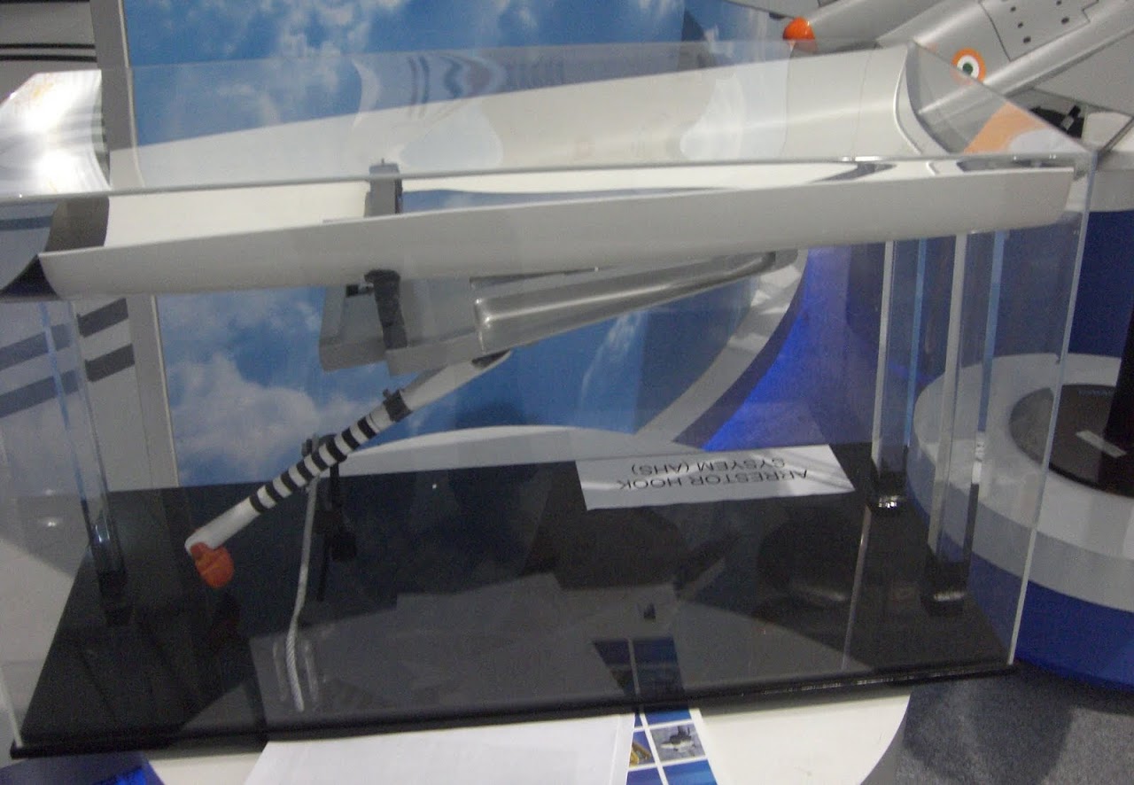

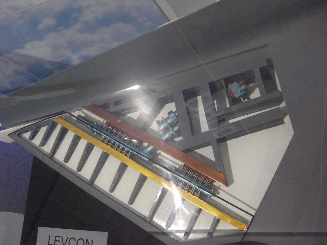

I've been trying to upload these photos on Br galleries, but can't log in,
anyhow, for record here they are
LCA Levcons
and
Naval LCA Arrestor Hook Assembly
Edit: Thanks Pratik saar
