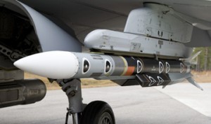

Arthuro, I guess you are wrong with your idea that eurofighter carries no external fuel at all for CAS.
Image Credit to Shae Ransom
Replace the centreline fueltank with litening III and 2 of the bombs with Brimstone triple racks and you just doubled the a2g load Tornadoes typically carry for patrols over Libya. Plus 4 additional AMRAAM/Meteor.
Way cheaper and looks more impressive than Rafale with 2/2 MICA IR/EM + triple rack of AASM.
That's what I mean when I bemoan the blanket statements about Rafales a2g superiority.
Tiffy lacks when it comes to carrying very heavy/bulky external stores (heavier than 1000 lbs or longer than 3m) over looong distances.
