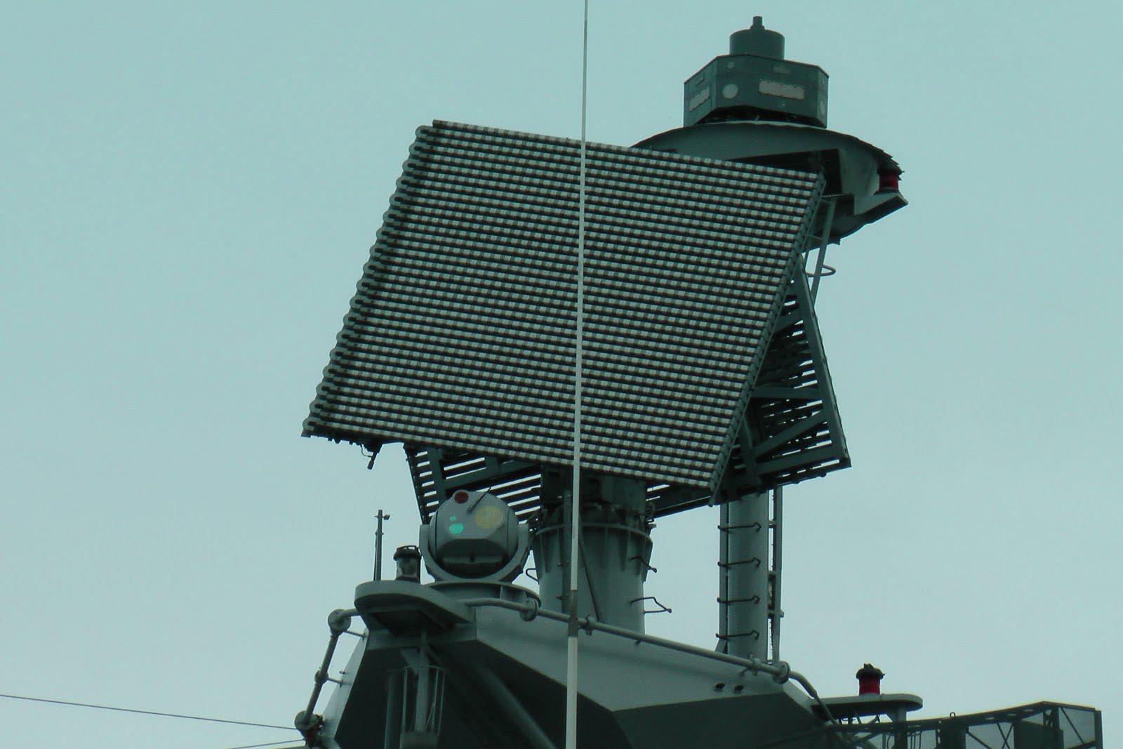

Optronics and radars on ships are exposed to sun all their lives. Yet they dont fail like avionics like HAL states. http://3.bp.blogspot.com/-HUTDk79tdgE/T ... tpura5.jpg
