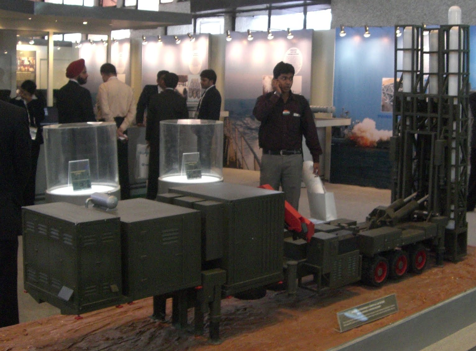

Re: Indian Missiles and Munitions Discussion
Hmmm, so this time they show the system on a Tatra 12X12.
While the Akash has been show cased in the IAF's Tata based tractor trawler.

Karan M wrote:
abhik wrote: If you are talking about the number of missiles in a TEL then i think it is 3 not 4.
It's 4.. there are other pics as well.
All the pics I have seen, the TEL carries only 3. For example NDTV's story @3:09
