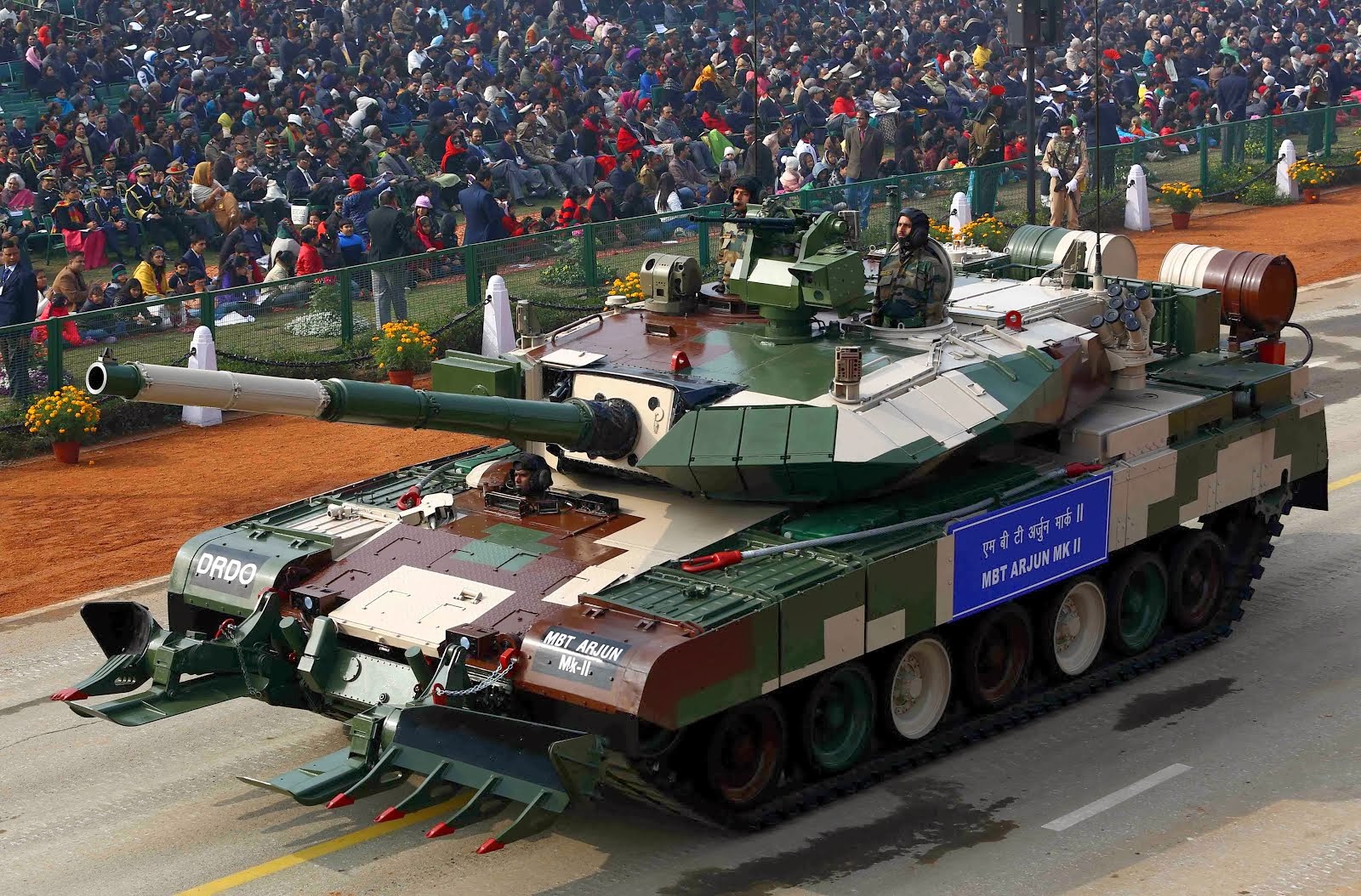

The glacis plate of the Arjun Mk II displayed in the Republic Day parade has some interesting rectangular indentations. Could they be placeholders for additional ERA bricks to protect the tank front?
On another note, it was interesting to see the multitude of desert camouflage schemes on display on IA armoured vehicles. In previous Republic Days we've also seen tanks sporting the 'digital' desert camouflage as well. Doesn't the army use standard camouflage schemes or are individual units allowed to paint their vehicles depending on local conditions?

Nope the CPS is actually above the turret, next to the anti-aircraft gun (it is in the same direction that Mr. Balaguru was pointing). In this picture, it is covered by a brown box.ArmenT wrote:If you look at the video posted by Austin above at around 06:58 (and my translation above), Mr. Balaguru points to it and says it is the CPS (Commander's Panoramic Sight).Viv S wrote:Can you take a picture of the turret's right side, if possible? Whatever gadget was there now appears wedge-shaped. Surprising since it should have offered negligible protection in the first place, can hardly take advantage of deflection. Its composition is likely very different from what we assumed.
This is the CPS of Arjun (called COAPS from Elbit) looks like this
You can see it from the republic day parade (click for higher reolution:
Re: Armoured Vehicles Discussion Thread - Jan 12, 2012
