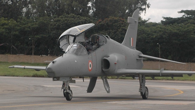

rrao wrote:The air intakes are too small which may make the engine starved of the critical oxygen during high "g: Maneuvers?
The wing length and dimension appeared to be too small !!!
The location of air intakes should it be above or below the wings for an optimal flight performance.
IJT was hurriedly conceived in 36 months because of which it is suffering from congenital maladies...Gurus please comment on the soundness of the IJT design..
what are the corrective actions which our learned gurus can indicate .TIA!!!!
Really small intakes ^
Didnt make much of a sound on take-off, a Cessna 152 could've/would've done a better display than the one this one put-up
Re: Indian Military Aviation- September 29 2013
has anyone mentioned size of intakes of IJT as an issue ? all ajt IJT have small intakes because the requirement isn't that large.
Intakes are sized as per required mass flow - an larger intake that attempts to push more air into the engine than the engine's mass flow rating will only result in spillage drag.
IIRC, air intakes not an issue.. (based on recollection of the last comprehensive piece I read).. noRaman wrote:Intakes are sized as per required mass flow - an larger intake that attempts to push more air into the engine than the engine's mass flow rating will only result in spillage drag.
