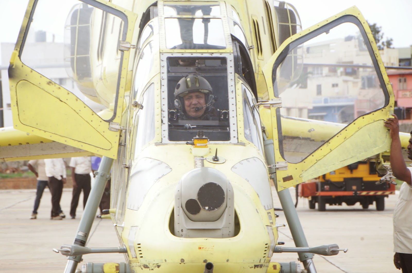

http://3.bp.blogspot.com/-J9M0X7UYFc0/V ... C_4630.JPG
All those rectangular panels I assume are access panels.
I also assume that they will have some sort of a cladding to make it stealthy. Unless they go with a paint, how will they tackle those panels?

Would be happy if you could explain how the panels affect the "stealth" of the aircraft and also the thing about paint in your post kinda didn't make sense too.
NRao wrote:http://3.bp.blogspot.com/-J9M0X7UYFc0/V ... C_4630.JPG
They could be panels where the metal is cut out and replaced with composite,making it lighter, tougher and more stealthy. Note that the peripheral angled parts could be metal and the flat bits composite.
The other question is, no matter what the Americans seem to be saying and doing, how important is radar stealth to a helicopter that will be directly exposed to enemy gunfire while approaching the area with stealthy nap-of-the-earth flying. Weight, noise and IR reductions would IMO be more profitable than a massive reduction in radar reflections - much of which comes from the rotors anyway rather than the body.
Reducing radar reflections will be key to reducing the range at which it can be detected if the opponent has located radars on tall masts for low flying objects
I agree.
"Stealth" never has meant "invisible". It has *always* meant later-the-detection-the-better. And, "stealth" comes in many shapes and forms.
Having said that I have been around Apaches (got some cool pictures too), but never took the time to look at "panels" - never struck me as an important item to look for nor did I "panels" stick out on that bird.
But, that particular picture struck me in two respects: 1) The shape of the bird - is clearly shaped to reflect as little as possible and 2) It seemed to have a lot of access panels - may be the numbers are justifiable, do not know - which is why I posed that question. The two seemed somewhat contradictory and yet it was there. So, the next question was how is such a problem solved (one was is to have saw tooth edges) - paint, some other material, ..........??????
Being a TD could be this is question too early in the process. Who knows they may even reduce the number of panels.
There should be a lot of armor plating around the pilots, engines and other sensitive areas. Not sure what materials are used.
