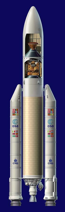

A similar mission was undertaken like LVM Mkiii by ESA using Ariane 5 in 1998, called ARD
Flight sequence diagram
