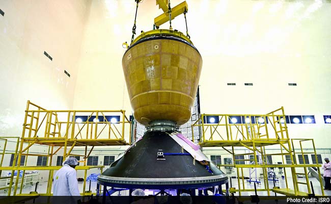

Question for gurus.
Before
After
Hmmm... Did it lose the top on the way down, or is this as per design? The exposed aluminum structure seems to be covered with a tiled enclosure. Hence my question...

rgsrini that top thing was to blow off to deploy the parachutes .If you see the original module you can see the joint line at that point.

Thanks for the confirmation prasannasimhaji. Do you know what the 2 holes and the big marshmallow on the top as well. I hope the heroes of ISRO publishes a detailed write up on the crew module and the experiments conducted in this iteration.

rgsrini wrote:
Before
Do you mean the white ring on the black reentry tiles? It could just be damage protection looks like..
