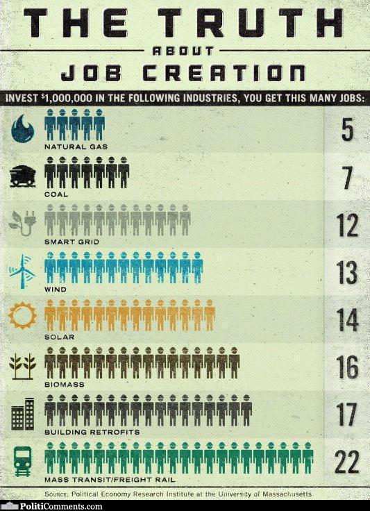

As per below, Solar generates maximum employment in Energy field and mass transit in infrastructure as whole.

Spending money does not generate employment. Spending money is spending money.Jhujar wrote:As per below, Solar generates maximum employment in Energy field and mass transit in infrastructure as whole.
You could "generate" a lot more jobs just getting people to dig holes and fill them up.
