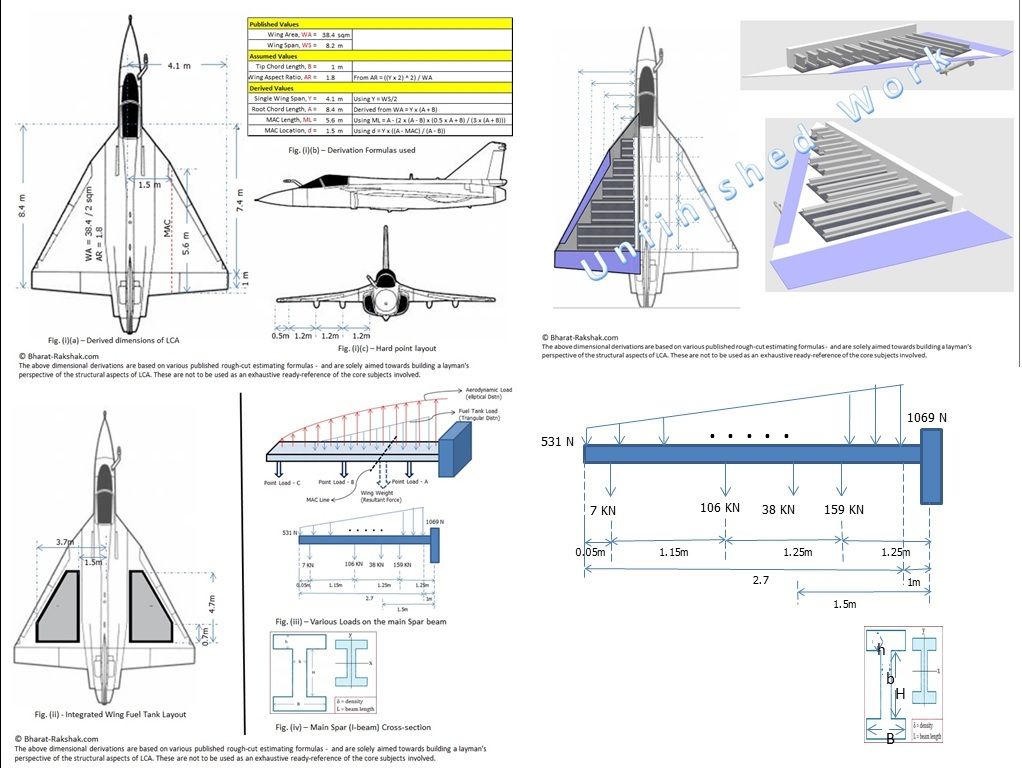

shiv wrote:LCA cutaway drawing
http://i384.photobucket.com/albums/oo29 ... lcacut.jpg
Unable to see the structures to which the landing gear is attached. But some guesswork is possible. If the landing gear weighs 500 kg normally - it will weigh 2500 kg in a 5 G manoeuvre (or 4000 kg at 8G) The LCA has now flown for a decade with this extra weight and clearly the airframe is able to withstand such stresses. Now if the weight of the landing gear is reduced by 100 kg, that translates to 2000 kg in a 5G manoeuvre - i.e half ton less (or 3200 kg at 8G - almost a ton less). That means that the structure that attaches the wings to the main frame can do with reduced strength and weight because of the reduced weight of the landing gear as G forces on that structure will be smaller.
The question may be one of engineering. What are the actual load and stress bearing structures like - what materials and strength? It is plausible that some of these structures are amenable to weigh reduction relatively easily - but obviously this is just "hopeful guesswork" on my part. No inside knowledge. But if someone from inside the program says it is feasible - there may be something to it.
My opinion. Happy to be corrected:-
MLG is nicely tucked in very compact position during flight. Also its placed very near to the CG of the aircraft. The stresses it induces during manoeuvre will not be so dramatic as with the case of say pylon load (which is trying to rip-off from the wing under G load causing large bending stresses at wing root). Of coarse some strengthening of surrounding structural parts is resulted by heavier MLG, but my guess is the sizing here would be decided by the impact loads at the time of landing rather than manoeuvre loads. Impact loads at the time of landing should be far greater than G loads caused by MLG on the structural components to which it is attached.
If we think about NLCA, the over-design was due to higher sink rate used for design, which means higher impact loads resulting in heavier MLG as well as heavier supporting structural components which need to absorb these higher impact loads ultimately.
The reduction in MLG weight and elsewhere will reduce total weight of a/c giving reduced impact loads on landing. This will allow some optimization of those inner structural components.

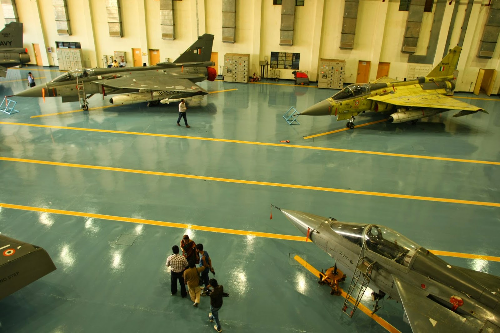

Karan M wrote:
indranilroy wrote:Karan, this is not from the new assembly hangar.
Do we have pics of that? Eitherways good to see HALs new lines - Su-30, Hawk and LCA as clean and well laid out.
http://tarmak007.blogspot.com/2013/12/f ... -hals.html

nileshjr wrote: MLG is nicely tucked in very compact position during flight. Also its placed very near to the CG of the aircraft. The stresses it induces during manoeuvre will not be so dramatic as with the case of say pylon load (which is trying to rip-off from the wing under G load causing large bending stresses at wing root). Of coarse some strengthening of surrounding structural parts is resulted by heavier MLG, but my guess is the sizing here would be decided by the impact loads at the time of landing rather than manoeuvre loads. Impact loads at the time of landing should be far greater than G loads caused by MLG on the structural components to which it is attached.
What you say is, I am sure, true, but no matter how close to the center of mass a particular item may be it will add to the stress between wing root and fuselage. 1000 kg sitting exactly at the CG translates to 5000 kg exactly at CG in a 5G manoeuvre and that 5000 kg is being held up by lift acting on the center of lift in the wing some meters away causing large stresses.
Anyhow - it does not matter whether the extra weight is because of landing impact or because of something else - there is a domino effect of increasing or decreasing weight so that every kg shaved off landing gear can translate to several extra kg shaved off other structures provided the engineers get their modelling and calculation right.

shiv wrote: What you say is, I am sure, true, but no matter how close to the center of mass a particular item may be it will add to the stress between wing root and fuselage. 1000 kg sitting exactly at the CG translates to 5000 kg exactly at CG in a 5G manoeuvre and that 5000 kg is being held up by lift acting on the center of lift in the wing some meters away causing large stresses.
What i meant is the support structures are already designed for much higher loads than what manoeuvrings loads of MLG would induced on them. Impact load at landing which is far higher than any load MLG could induce at 9G, will be the criteria deciding support structure's design and weight. So reducing MLG weight does not result in any (or perhaps any significant) weight saving in support structures.
I talked to a friend who was leading structural analysis project for MLG and its supporting structures for one of the Airbus Airliners. He corroborated my logic saying for airliners they never even considered manoeuvrings loads on MLG (though civilian jet are designed for 2.5G AFAIK the LG is much much heavier than MLG of fighters which are typically designed for 9G). They would design the MLG and its support structure (its attached to rear spar and False rear spar of the wing using one hinged joint and one ball-and-socket joint) for impact load at landing which is calculated as 4.5*Empty weight of aircraft (impact loads would be about ~2-2.5 times the actual landing weight, you can work out this ballpark figure easily considering the vertical momentum that has to be absorbed by the MLG/Support structures). Considering we can use similar methodology for LCA (albait military jet must be designed for higher sinking rate thus the factor might be higher, but lets keep it aside for brevity), the support structures would be designed for 4.5*6500kgf ~ 30000kgf i.e. 15000kg on each MLG. The MLG for LCA, over-designed as they may be, are still quite light. Even at 12G ultimate limit the forces would be far far less than 15000kg at any rate. If you consider from fatigue design POV they are inconsequential at those levels.
Also please note that there is locking mechanism which holds the landing gears when they are retracted, hence the G loads induced by them are shared by two spars and the locking link, reducing the effective stress on the spar linkages even further.
So unless there is any change in Max allowed Landing weight, there will be no redesign of support structures and even otherwise I do not think there will be reduction by "sevaral kgs on support structures per kg reduction in MLG weight".

No no no no. You and I are talking about two completely different things. I am not talking about landing stresses on the landing gear and support structures at all. There may be scope for weight reduction in other areas as a consequence of landing gear weight reduction, which I will explain.
If you ignore fuselage lift and consider the wings as the only (or main) lifting surfaces, those wings are attached to the fuselage by spars while the fuselage itself acts as a deadweight. On the ground the spars support the weight of the wings acting through the spar/s. In flight those same spars support and lift the deadweight of the fuselage. The wings are lifted up (by aerodynamic lift in flight) and that lift is transmitted via the main spar/s to lift the dead weight of the fuselage. Under high G circumstances (in all aircraft) the wings are trying to tear themselves off the fuselage, but they do not tear off because the spar/s are strong enough to remain attached to and support the fuselage at the point that they are attached to the fuselage. The heavier the fuselage, the greater the stress on the fuselage-mainwing spar/s joint in flight and high G stresses are correspondingly greater.
The lighter you make the fuselage - the less the stress on the fuselage-spar joint and the spars themselves during flight. Any weight reduction of the fuselage - be it main gear or anything else would lead to a corresponding decrease in the stresses on the main spar and spar-fuselage joint. A mainwing spar that is strong enough for a 10 G manoeuvre on a 7,000 kg plane would be over engineered in case the maximum weight of the aircraft for a 10G manoeuvre is only 6,000 kg. The entire mainwing spar and/or its joint with the fuselage can be made a little lighter for a lighter maximum weight in the fuselage.
That "lighter fuselage weight" could be by shaving off some weight from an over engineered landing gear and that leads to the possibility of shaving off even more weight from over engineered wing spars that no longer need to fly with as heavy a weight as they were originally engineered for.
JayS
Posts: 4567
Re: LCA Tejas: News and Discussions
Post by JayS »
shiv wrote: :)
Gotcha...May be I could talk to some of my colleagues who work on wing spars and see what are the possibilities in this direction.
But above is a much bigger effort. Its almost like re-assessment of entire structural design of the aircraft. And it will alter weight distribution, if we consider this resulting in shaving of 500kg material from a lot of places. It will take lot of time. Its upto the program managers will need to take a call whether the time and efforts are worth the gain from such endeavor. I doubt this is on the cards for MK1A as this could easily spiral into too large design change. But then its just my opinion.
One more silly point came to my mind just now. It looks like MK1 will be +8G fighter after all. From my understanding, this is aerodynamics-propulsion related limitation and not the structural limitation and as such the entire structure must be designed for 9G max nominal load from starting. So could downsizing entire structure to 8G result in some more saving?? If anyway it boils down to re-assessment of entire structure, why not include this into it as well?? On the other hand, if the resulting MK1A is expected to fulfill 9G requirement then this particular point is mute.
maitya
Posts: 866
Joined: 02 Feb 2001 12:31
Post by maitya »
shiv wrote:
<snip>
The lighter you make the fuselage - the less the stress on the fuselage-spar joint and the spars themselves during flight. Any weight reduction of the fuselage - be it main gear or anything else would lead to a corresponding decrease in the stresses on the main spar and spar-fuselage joint. A main wing spar that is strong enough for a 10 G manoeuvre on a 7,000 kg plane would be over engineered in case the maximum weight of the aircraft for a 10G manoeuvre is only 6,000 kg. The entire mainwing spar and/or its joint with the fuselage can be made a little lighter for a lighter maximum weight in the fuselage.
Aha!! Spars, Fuselage, Wing-sections ityadi ityadi is it? Time to bring out the hand-created collage of my unfinished anal-ysis of LCA structure etc, a few months back.
(the 80% complete write-up will not see daylight, as this one of those started-but-never-completed-writeups that gets accumulated in the hdd (periodidcally, until the next hdd crash :roll: ).
Anyway here it's ... I-beams and what not of Yell-Cee-Aaa's wing-boxes etc.
Anyway, pls carry on ... nileshjr, you are spot on, all these talk of 1K weight-loss looks to be hog-wash leading IAF on another garden-path (believe me I'll be the happiest person if I get proven wrong, and forced to eat my words above).
It's not very difficult to do an estimate of the LG weight (there are various approximate stats tool available for it - stuff like landing gear length etc - similar to the Wing weight estimation done in the above-never-bought-online write-up mentioned above).
