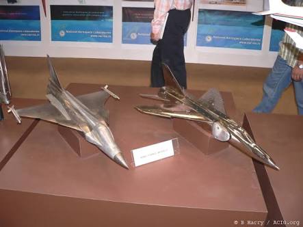

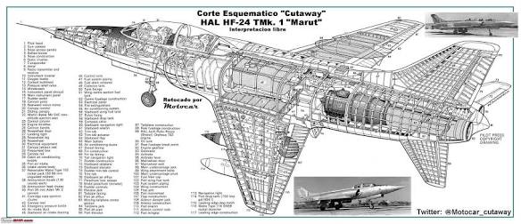

ramana wrote:
Kanson is right. Shiv had posted gifs of many HAL concept planes in the mid 70-80s. Shows design bureau was active.
Where can I find these gifs?? Can you or Shiv, please provide link??
Re: LCA Tejas: News and Discussions
Looks like most of these scans all came from the same book:
