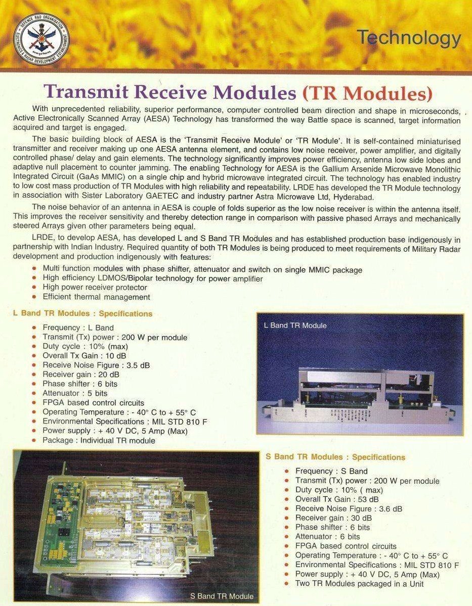

The point that I was making is that the LRTR is a more powerful system with better reliability (AESA vs PESA) plus the other advantages (gain/noise etc). Even the MFCR was similarly, an AESA. We chose these expensive & maximized configurations because we wanted a no holds barred BMD system the same as Israel did.
No doubt AESA is better then PESA when it comes to reliability and no doubt Israel helped us a lot with LRTR including TR module etc which is essentially GP indian version , The Russians dont have any one to help except themselves , they were good with PESA with different generation and invested a lot in it so they went with what they knew best , AESA would come now since they have maturity in program , Check the interview on AESA on PAK-FA thread he designer says took them 13 years to be where they are now.

The MEADS PAC-3MSE has AESA AFAIK atleast for long range tracking a new type L Band , Their MFCR I think still uses PESA but not really sure.
The Patriot and its follow on/of-shots can be loosely put into Standard Patriot, Patriot Adv. and MEADS. All three can and will use the new Pac-3MSE missile but only the Standard Patriot will use the more Air breathing threat specific older missiles. The standard patriot uses a PESA, the Advanced Patriot upgrades include a Gallium Nitride AESA portions of which have been demonstrated this year, with full systems demonstrations expected in the first quarter of 2016. That radar is cleared for export (GaN AESA) and the only one now being actively marketed by Raytheon. The Patriot also works with the THAAD's AN/TPY-2 where both systems are deployed. The US Army will be choosing the Gallium Nitride equipped radar path unless they plan on holding a competition for a sensor (unlikely).
MEADS uses 2 radars, both GaA AESA. One is a UHF band sensor, and the other an X band sensor. The X-band GaA radar designed and built by Lockheed has an open architecture and enough power and cooling to allow swapping out of T-R modules as soon as affordable GaN T/R modules are available to current and future customers. There are no plans to demo MEADS + THAAD sensor interoperability although MEADS is designed to offer plug and play capability with non-MEADS radars but obviously someone has to fund the testing and whatever little integration is required at the BM level. The THAAD's AN/TPY-2 also transitioned to Gallium Nitride electronics late last year or early this year and the transition will be gradual as the radars come back to CONUS through regular rotations.
The good part is now they have AESAs for the Nebo-M system, hopefully we get a few VHF AESAs with the S-400 for counter stealth!

I think the area where India lags behind right now is not radar tech, good progress has been made, supposedly the LRTR can detect a cricket ball sized object at (600 kms?). It is fast acceleration long range ABM missiles that are missing. Wasn't there supposed to be AD-1 and AD-2 missiles developed as a follow on to AAD/PAD? What happened to those?
Agree, its the missiles where we need to pick up pace. The LRTR can detect a 0.1 Sq Mtr target at 600km. In short, 3.7 times the performance of the S-400 Big Bird radar.

I put this out there for other folks who are interested, about the current LRTR.
A LRTR has two elements to it - the hardware & the software. This:
https://1.bp.blogspot.com/_44d3OT-xI3U/ ... r+AESA.jpg
- these are the crucial TR Modules for even which we have our own design and this is from several years back & these are in assembly at BEL. The L Band ones are the ones used for the LRTR. If you pick up a paper released on the GreenPine by IAI several years back, you'd see the modules are of similar layout and design. Apart from this there are many other components which go into a radar - all of which are being made for AESAs by Indian firms & for the LRTR itself, way back, the same firms & people were roped into to indigenize the critical hardware within the radar.
Next, the signal processing for AESAs is being done in India as is the data processing.

This was also an interesting find by a person how DRDO was testing and its plans for the LRTR. Looks like they set up a facility specifically for low rate assembly and production of the LRTR on their own. The number required would be limited.
http://sniperz11.blogspot.in/2008/02/dr ... ility.html
Of course subsequently BEL started assembling the TRMs along with a bunch of pvt players, the hardware also got support from MSMEs and SMEs (the usual bunch).. so AESA radar development has advanced by leaps and bounds in India.
The next threshold which DRDO is clearly aiming for are higher power systems above & beyond what they have today. At Aero India there was another "reveal" about some AESA programs.
I am in two minds whether to post all that (is it even worth the effort?) plus whether it draws undue attention to information, even if it is public. That is the reason I deliberately held off from going into subcomponent level stuff which can point to how we are making all these radars inhouse. DRDO has spent the time & effort & it has paid off.
