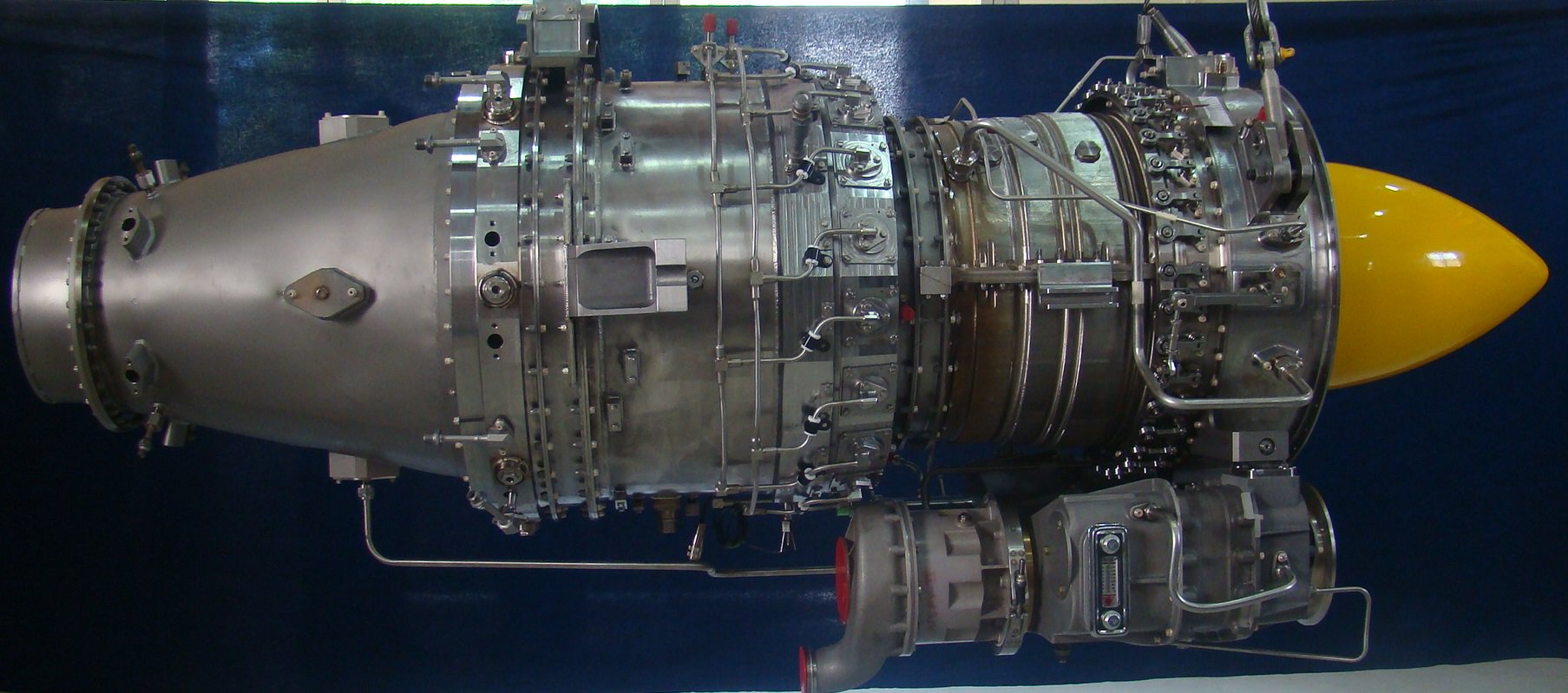

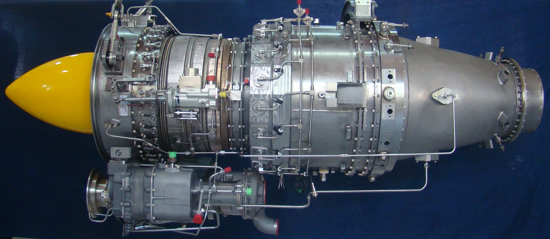

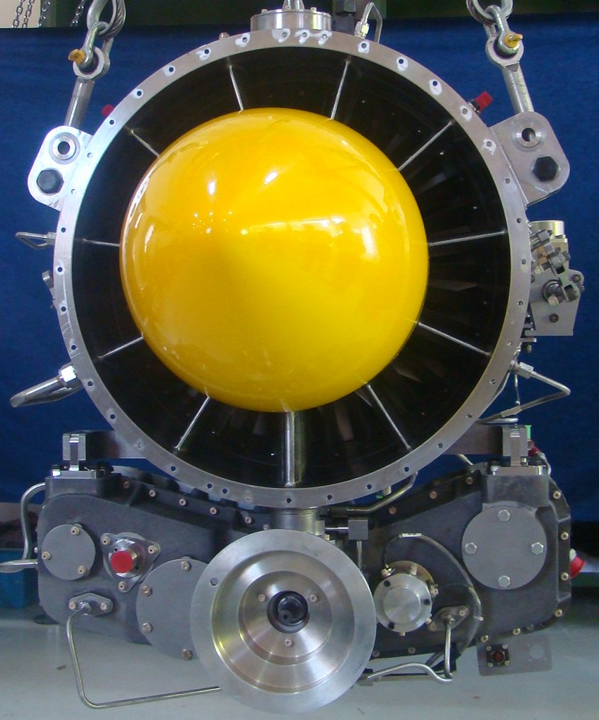

Anantha Krishnan M✈ ‏@writetake
Here's the 25 kN aero engine from the hangars of HAL http://bit.ly/1mjz91v @PIB_India @manoharparrikar
Rear view of 25 kN aero engine from HAL http://bit.ly/1mjz91v @PIB_India @manoharparrikar @Oneindia
And the last one for the day 25 kN aero engine http://bit.ly/1mjz91v @manoharparrikar @Oneindia
Another view of 25 kN aero engine from HAL http://bit.ly/1mjz91v @PIB_India @manoharparrikar @Oneindia

HAL should work with private sector: Parrikar
Manohar Parrikar, Minister of Defence and T Suvarna Raju Chairman and Managing director Hindustan Aeronautics Limited ( HAL ) during the maiden run of India's own indigenous 25 kN Aero Engine being produced by HAL in Bengaluru on Monday 14 December 2015. Photo : Sudhakara Jain.
Defence Minister Manohar Parrikar said on Monday that India would need 4,000 to 6,000 helicopter engines in the next 15 to 20 years.
“If you make it in the time frame allotted, it will be a big achievement,” he said. Mr. Parrikar was speaking after launching the maiden run of the core of 25 kN indigenous Aero Engine (Hindustan Turbo Fan Engine – HTFE 25) developed by the Hindustan Aeronautics Ltd.
To be used in military trainer aircraft, small regional jets and unmanned applications, the engine’s launch coincided with HAL’s 75 year of existence.
The design of the Hindustan Turbo Shaft Engine (HTSE-1200) was also launched during the occasion.
Though the Defence Minister commended India’s progress in aeronautical engineering, he said, “But we haven’t been able to pass that threshold required to go into the higher sector of aeronautical engineering.”

TOI(let) says that in addition to the 25KN turbofan engine, HAL is developing a HTSE 1200 (i.e. 1200 bhp turbo shaft engine ) for helicopters , basically for the LUH (1 engine) and Dhruv (twin engine).
Now if they put in gear train and stuff in front of a customised LP spool , you can get a Turbo Prop as well, which might be decent for Dornier or slightly larger sized planes.

vina wrote:TOI(let) says that in addition to the 25KN turbofan engine, HAL is developing a HTSE 1200 (i.e. 1200 bhp turbo shaft engine ) for helicopters , basically for the LUH (1 engine) and Dhruv (twin engine).
Yes vina ji. Found another article in gazettestandard. I hope this is just a tipping point in local engine manufacture, and wish to see a family more capable engines roll by.

With 2 of these modified as high bypass variants regional jets and transport aircraft for military are possible too.

Thanks for the explanations Indranil & Nilesh garus,
Some pics of interest(especially wrt 3D printed turbine blades) from the HTFE-25 presentation culled from https://aquantumofmind.wordpress.com/2015/10/

^^ That's my webpage. :mrgreen: Screenshots from the AI seminar video only. The seminar is a must watch. Link posted above.
