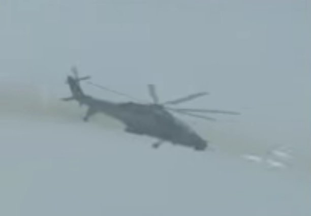

Post by Kakarat »
A screenshot of LCH firing Rockets at Iron Fist 2016 from my twitter page @kakarat2001
Kakarat
Posts: 2221
Joined: 26 Jan 2005 13:59
Post by Kakarat »
GIF of LCH firing rockets at Iron Fist 2016 from my twitter page
https://twitter.com/kakarat2001/status/ ... 0981724162
