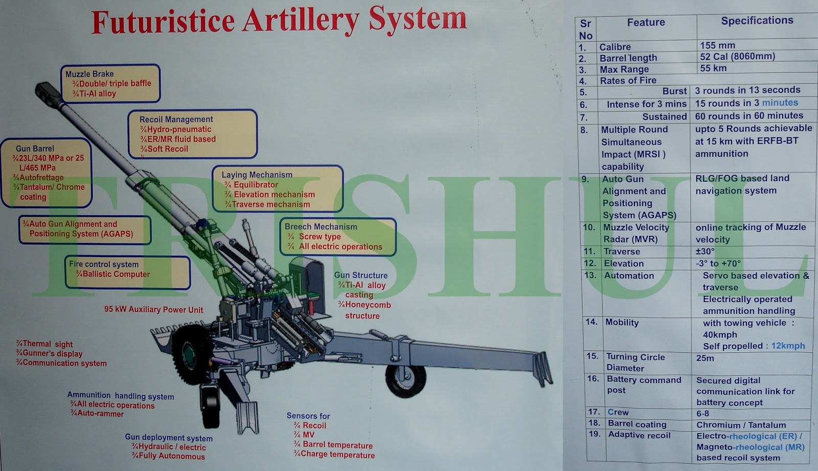

ATAGS
https://1.bp.blogspot.com/-eGP39CxFC-o/ ... TAGS-1.jpg
More details on electronics and work done by Kalyani https://2.bp.blogspot.com/-TR4WB8Sqn60/ ... TAGS-3.jpg
In both these brochures, the recoil system and the hydraulics for elevation are much smaller than FH-77B or Dhanush.
The self propelled APU shows 4 roadwheels in the Tata brochure https://1.bp.blogspot.com/-XVpTgBxnOvg/ ... TAGS-2.jpg
