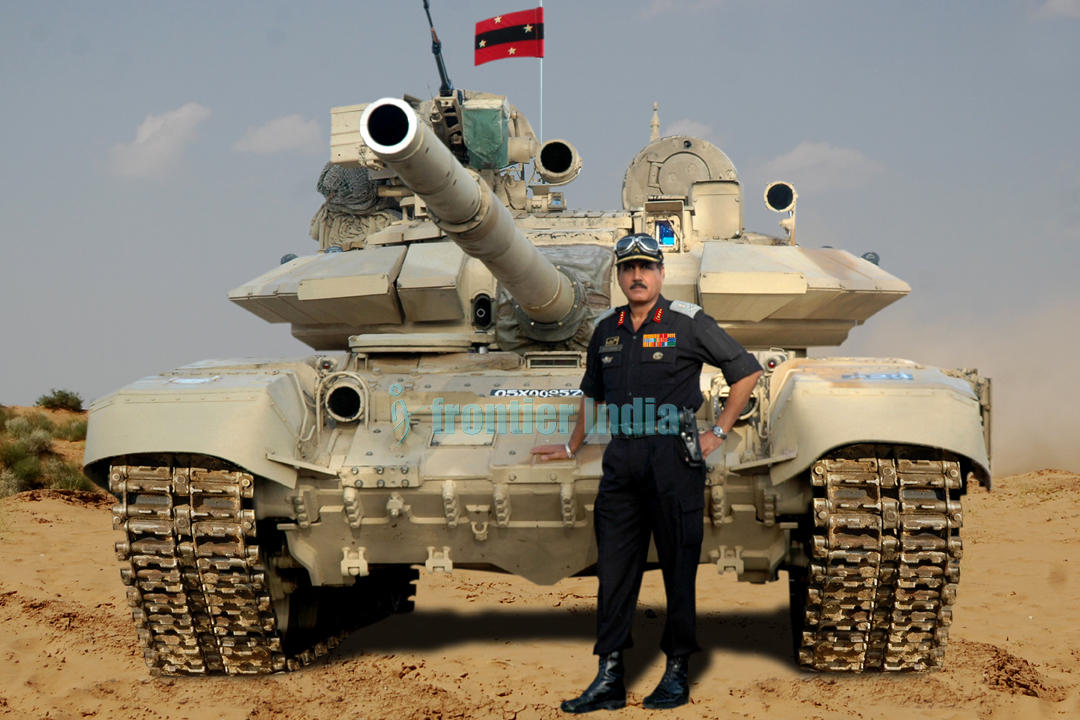

Re: Armoured Vehicles Discussion Thread - August 9 , 2014
Lt Gen Ak Singh, GOC-in-C, Southern Command ( Retd )
