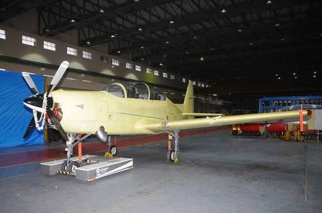

The fangs are the exhausts ?
Lalmohan
Posts: 13257
Joined: 30 Dec 2005 18:28
Re: Indian Military Aviation - 21 Sept 2015
Post by Lalmohan »
yes and the 'eyes' are inlets
nice mouth

someone on another forum had mentioned how the positioning of the exhausts downwards, will lead to problems with getting hot exhaust gases directed at the landing gear and the tires..especially when the airplane is on the ground, taxiing or waiting on the apron for prolonged periods. Overheated tires could burst.
I've looked at all other trainers I could think of and their exhaust is directed more in a direction towards the cockpit..basically upwards of the landing gear.
nileshjr wrote:
indranilroy wrote:CONGRATULATIONS HAL!!! I have supported this project from its inception. So, I am super happy. The jingo in me still wanted to see them retract the wheel and perform some acrobatics in the first flight itself, in honour of their inspiration: Dr. Ghatge, Capt. Jimmy Munshi and the HT-2.
IR, did you see the video posted few posts ago of HAL presentation?? It mentions that HAL in 1951, when flew HT-2 for the first time, the pilot performed all kinds of manoeuvres such as climbs, turns, stalls and even spin, in 40 odd min flight..!! Now that needs some balls.
We are speaking of Capt. Munshi here. Both HT-2s real first flight and Capt. Munshi's stint as HAL's chief TP. A worthy read for any Indian aviation aficionado.
Kartik wrote:someone on another forum had mentioned how the positioning of the exhausts downwards, will lead to problems with getting hot exhaust gases directed at the landing gear and the tires..especially when the airplane is on the ground, taxiing or waiting on the apron for prolonged periods. Overheated tires could burst.
I note that in the Pilatus PC 7 and PC 9 the main wheels are placed closer to the fuselage and retract outwards and are more likely to be in the path of the exhaust. Hence the exhaust pipes are pointed away from the wheels. The HTT 40 has mainwheels that are situated further away from the fuselage and retract inwards and are much farther away from the exhaust stream close to the fuselage.
Overheated tyres could burst? That is an interesting argument but I just want to point out that the exhaust stream is blown away by the propeller. Even without that it would take fairly close proximity to get the tyre temperatures up to dangerous levels. In India - tarmac temperatures of 50 degrees Centigrade are common. Rubber melts at 180 degrees and unless the exhausts were in very close proximity to the tyres it would be difficult to raise tyre temperatures above 40 degrees on exhaust gases alone. Human body temperatures are around 37 deg C, and 40 degrees would feel warm to touch and 50 degrees C hot but stiil just touchable. 60 degrees is too hot to touch.
Also:
http://code7700.com/g450_landing_gear_tires.html
Tire temperatures can rise in excess of 200°F (93°C) above ambient during operation.
That apart - in the image of the Shorts Tucano linked below - why does nobody worry about melting and overheating of the fuselage skin just inches away from the exhaust pipes? No one ever seemed to a ask these questions until someone saw an image of the HTT40
https://upload.wikimedia.org/wikipedia/ ... o-1449.jpg
The real issue as I see it is doubting the ability of Indian engineers to think of a fairly basic no brainer issue while designing an aircraft - in keeping with a general feeling that our people tend to make silly mistakes.
This "exhaust pointing down" argument reminds me of the first mock up images of the LCH when some wisecrack commented that having an EO ball above the nose would make things below the helo invisible. Yeah right. But the EO ball is meant to see what is in front and below and by placing it above the nose it is better placed to see aerial threats like UAVs above the helo. Another example of thinking that the Indians must be stupid. It was only set right when Hari Nair came on here and said it was fine.
HTT-40 mock had the exhaust like PC-7II.
But on the prototype it has changed to something like Short Tucano.
Anyone know the advantages of either placement? Or is it related to the type of engines being used?
The red one is a mock up. The undercarriage & actuators are solid rods
The placement of the exhaust has nothing to do with the airplane designers, but everything to do with the design of the engine fitted into the plane. When the mockup was shown in AeroIndia11, they had planned to go with a PT6A which has the exhaust on the sides. However, during the course of the final design, they chose the TPE331-12B engine which has its exhaust at the bottom. I leave it to interested members to learn why the TPE331-12 series,14 series etc. have the exhaust at the bottom.
And no, the exhaust warming up the tyres is a non-issue. I have never come across this.
Post by tsarkar »
indranilroy wrote:When the mockup was shown in AeroIndia11, they had planned to go with a PT6A which has the exhaust on the sides. However, during the course of the final design, they chose the TPE331-12B engine which has its exhaust at the bottom.
If memory serves right, the Garrett TPE331 is the same engine as Dornier Do228 built in 100s by HAL, and has proven reliable characteristics in multiple environments across India. Good move that reduces program risk.
Post by GeorgeM »
Exhaust should not be an issue. Typical exhaust temperatures for Diesel engines are around 1350F (~740C) with turbo charging. Assume Turbo consumes some of the energy (~20-30 %). Assume aviation exhaust temperatures similar to diesel. But about a foot away from the exhaust stack, the temperature drastically drops to around 400-500 F (260C). This is due to looses from mixing and radiation.
With landing gear that far away (looks like several feet from pic), temperature from exhaust should not be a problem at all, even for slow speed taxi. At take-off speeds, the mixing is significant.
indranilroy wrote:The placement of the exhaust has nothing to do with the airplane designers, but everything to do with the design of the engine fitted into the plane. When the mockup was shown in AeroIndia11, they had planned to go with a PT6A which has the exhaust on the sides. However, during the course of the final design, they chose the TPE331-12B engine which has its exhaust at the bottom. I leave it to interested members to learn why the TPE331-12 series,14 series etc. have the exhaust at the bottom.
It appears that there are a few aircraft in which the engine is mounted upside down, with intake above the prop hub and have the exhaust pointing backwards
Yes, the intake can be above the propeller shaft, but it is not an engine mounted upside down. This is not typically down for a single engine aircrafts as its hampers visibility over the nose.
well, I've come up against an issue with ECS pack causing overheating of panels, which was only noticed during a very late phase of the design. led to a heck of a lot of rework. So, these things can happen. But seeing the Shorts Tucano as per your last post did make it appear that this particular exhaust placement may probably be a non-issue. Which would be good, since any re-design would lead to added time to the schedule.
Shiv saab, tyres can burst due to excessive heat. But maybe the wash from the propeller diffuses the heat, so it may not be an issue at all in service.
Since the intake is for a centrifugal compressor you can have the opening anywhere on the circle - up, down or sideways. Likewise you can place the engine itself anywhere around the propeller. UP or Down make most sense from aircraft design point of view. So in a way you are right. But this does not affect the exhaust position. This is the cross section of TPE331 engine. You can see what Up or down really would be from this image. Putting link as image is too big. As IR already pointed out, putting air intake above for nose mounted single engine birds would hamper visibility over the nose. While for the multi-engine, wing mounted aircrafts, both up and down configurations are in use.
https://en.wikipedia.org/wiki/Garrett_T ... utaway.jpg
The difference in exhaust position is due to the fact that the PT6A engine is reverse flow i.e. intake at the back and exhaust at the front. See last part of this video which shows the airflow. OTOH the TPE331 engine is usual front intake-back exhaust flow.
Interestingly this one aircraft which used PT6 in pusher configuration looks more natural in terms of placements of intake and exhaust since reverse flow becomes straight flow here due to reverse mounting of the engine itself.
Another interesting difference between the two engines (unrelated to the exhaust position) is the former is two-shaft design and the later is single shaft - which is the reason i think that the later one needs big reduction gear box for the propeller.
Among multi engine a/c the BAe Jetstream and OV 10 Bronco have the engine mounted "upside down". The new single engined Garett powered Antononv AN-2 also has an "upside down" Garett TPE 331
https://img.planespotters.net/photo/344 ... 344050.jpg

Aditya G wrote:Is Garett TPE 331 license produced by HAL? Smart engine choice by HAL in any case, compared to the Sitara IJT fiasco.
Yes, very smart to reuse the basic Do228 engine license produced since 1988.
Though the 12B is a newer version with higher power. Presently HAL can service 12 series engine, but I speculate a license manufacture will shortly follow.
http://www.hal-india.com/Product_Detail ... y=&CKey=29
The Garrett TPE 331-5 Turbo prop Engine is being manufactured, overhauled and repaired for various Customers under licence from Garrett Engine Division of Honey Well Company [earlier Allied Signal Aerospace Company, USA] since 1988 and belongs to one of the most popular series of small Turbo prop Engines powering a large number of Commuter and Corporate Aircraft such as Dornier DO-228.
It has a single shaft Centrifugal Compressor Engine rated at 715 shaft horse power at 1591 RPM output speed. Being a reverse flow Gas Turbine with a small frontal area, it has better dry specifics and easier airframe integration. Apart from its simplicity of design and superior performance, the engine features a propeller control system, anti-icing and foreign object damage resistance, reverse thrust and negative torque sensing facilities. The division is also an authorised service centre for Garrett TPE 331-5 series engines up to - 12.

Here's my contribution to the exhaust up/down/port/starboard and engine up/down/port/starboard discussion.
The TFTA MQ-9 Reaper that uses the same Garrett 331 engine in a pusher configuration

I have a question about the HTT 40s exhaust pipes and this is a thermodynamics type of question for which I have no answer - only guesswork. The issue is minor.
If you look at the enlarged area of the HTT 40 image below you find that the exhaust pipes are cut "obliquely" and not orthogonally to the axis of the pipe. Many other aircraft including the image of the An-2 I have linked above have the exhaust pipe cut orthogonally. The oblique cut appears to be a design choice rather than a cosmetic variant.
From the rudimentary school level thermodynamics I can recall there are some design advantages in cutting the pipe obliquely in some situations. In this case the area of the outlet is larger and would lead to early cooling of gases and mixing with ambient air, apart from redirecting the exhaust flow away from the axis of the pipe - just like those AK-47s whose muzzle is cut obliquely to create an up-blast to counter the bucking up tendency of the AK-47 whose barrel is located above the center of mass.
Also - the engine is after all a jet engine and the mass of air flowing out is what would be expected from a jet engine and must be producing some degree of thrust - however minor. I wonder how much the exhaust outlet configuration is designed to utilize (or minimize) that thrust?
