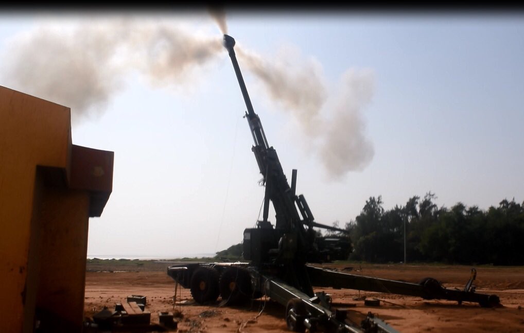

I see from pix that ATAGS apart from having high angle fire (haubitze) also has low elevation D-30 type direct fire (field gun). I read it has a thermal imager also.
hopefully IA will not put in a req that it needs a FCS to hit on the move targets like a tank can do. its direct fire mode I see as a emergency if position is about to overrun or if its on a hill and needs to fire down at targets below.

Re: Artillery Discussion Thread
Post by Bheeshma »
Is the weight 12 tonnes as DRDO promised ? Else IA will again use it as an excuse to buy some foreign crap. Anyway a good beginning for Arty. Needed these 155mm and Pinakas like yesterday. Hopefully the same gun can be used for Mounted and Wheeled SPG's. I guess on to Pinaka-II and Prahaar after this.
Post by Avinandan »
Singha wrote:I see from pix that ATAGS apart from having high angle fire (haubitze) also has low elevation D-30 type direct fire (field gun). I read it has a thermal imager also.
Singha Saar, I suspect they will ask for Bofor's like ammo crane. IMHO they are quite useful for sustained firing.
Additionally, please advise on the demerits of Bharat-52, Turkish Panter design?
One thing to this Abdul's eyes is the inability to rotate in its axis quickly like the Bofors design does.

Posts: 2429
Post by Thakur_B »
Has there been any clarity on ATAGS chamber volume, 23 or 25 litres? The latter would be a better scenario.
Post by Bart S »
Pistol mode is essential for giving thappad to Pakis on the border during peace time.
What is the use-case for a thermal imager?
Am I the only one who is seeing the G5 lineage in the carriage. The gun seems to be some thing else entirely.
Singha wrote: hopefully IA will not put in a req that it needs a FCS to hit on the move targets like a tank can do. its direct fire mode I see as a emergency if position is about to overrun or if its on a hill and needs to fire down at targets below.
The moving target requirement is met by tanks, not artillery
Positions about to be overrun require heavy and high rate of fire at ranges of less than 1 km where terrain is a problem. Artillery is generally unsuitable for that - unless Tipu Sultan type muzzle loaders are used. But AAA like Bofors L-70 will work
Post by rohitvats »
Pratyush wrote:Am I the only one who is seeing the G5 lineage in the carriage. The gun seems to be some thing else entirely.
On the contrary, G5 derives its lineage from Austrian GC-45 designed by Gerard Bull - the same gun whose manufacturing/production set-up and everything else was scooped by Kalyani.
Gerard Bull worked with South Africans (Denel) on the artillery bit quite extensively - the mobile mounting was designed by Denel for the gun designed by Bull. G5 is further evolution of Gerard Bull's design by Denel.
Post by Aditya G »
Actually in our scenario firing in low elevation is a key requirement especially in mountains. We extracted price from pakis on LoC as recently as this year when firing I pistol mode.
Rohit. I said carriage and not the whole gun system.
Post by rohitvats »
Pratyush wrote:Rohit. I said carriage and not the whole gun system.
The BHARAT-52 gun proposed by BF had somewhat similar layout. But closer inspection shows this layout is indeed very similar to two guns - DENEL G5 and Soltam ATHOS-2052.
1. GHN-45 - https://i.ytimg.com/vi/Lm4T8tKdaBA/maxresdefault.jpg
2. ATHOS-2052: http://4.bp.blogspot.com/-O9WDri5uCvI/T ... S-2052.jpg
3. Denel G5-52: http://www.army-guide.com/images/p0567818.jpg
thermal imager is for night firing/dust/rain etc where visibility is poor. another tidbit is the syrians are using the new thermal imagers on their T72 tanks (25% changed so far) to locate and take out rebel snipers...in the daytime. the heat and muzzle flash of a gun registers loud and clear.
Can someone explain to me the need for a Thermal imager or a dynamic stabilization system for an artillery piece that is expected to sit in one place hit targets 30-40 km away way way out of line of sight.
Note that a parabolic path that takes a shell to a distance of 40 km may be at least 60 km long and at a muzzle velocity of 800 meters per sec it will take the shell several minutes to reach the target so hitting a moving target is not what it is meant for. Hitting a moving target would require tracking of the target by UAV/aircraft PLUS terminal guidance of a normally dumb artillery shell.
Thermal imagers would not be useful except within line of sight. From the ground - in mountainous terrain that maye be s little as a few hundred meters up to a few km. 40 km is unlikely
Post by Mihir »
All modern howitzers are capable of firing at low angles. The FH-77, Dhanush, ATAGS can all do it.
Indian arty crew are trained fire over open sights. There's no FCS to track and hit moving targets, but they could hit tanks in a pinch. A 155mm HE shell hitting the hull or turret would pulverise the crew.
Mihir wrote: Indian arty crew are trained fire over open sights. There's no FCS to track and hit moving targets, but they could hit tanks in a pinch. A 155mm HE shell hitting the hull or turret would pulverise the crew.
The only problem is that while elevation and depression are built-in features of artillery, side-to-side traverse is not. The gun position would have to be "re-laid". So that means that unless a tank just happened to be sitting static in line of sight of the artillery piece it would not get hit. In a hypothetical face-off between one tank and 3 artillery pieces at 1500 meters from each other the tank with its mobility and 120 mm gum would be able to finish off all 3 artillery pieces because of its rate of fire, mobility and ability to traverse and fire on the move
Artillery is more like air force. Hitting at a distance and devastating an adversary. Not close in fighting.
But I think 105 mm field artillery can be rotated and re-laid manually, quickly
Post by rohitvats »
shiv wrote:The only problem is that while elevation and depression are built-in features of artillery, side-to-side traverse is not. The gun position would have to be "re-laid". So that means that unless a tank just happened to be sitting static in line of sight of the artillery piece it would not get hit. In a hypothetical face-off between one tank and 3 artillery pieces at 1500 meters from each other the tank with its mobility and 120 mm gum would be able to finish off all 3 artillery pieces because of its rate of fire, mobility and ability to traverse and fire on the move
Shiv - many Soviet artillery pieces came with traverse capability. The degree of traverse depended upon the intended use of the piece. For example, M-46 (which was and remains long range medium artillery piece) comes with 50 degree traverse while D-30 gun comes with 360 degree traverse. 50 degree traverse for M-46 should mean 25 degree either ways from centre-line.
Guns like D-30 were designed from ground-up to also have anti-tank capability in addition to populating the field regiments which have lower range than likes of M-46. I think this ability of lower caliber guns in Field Regiments to traverse along wide arc is carry forward from WW2. Field Regiments had lower range which meant they were that much closer to the front-line. In case of enemy breakthrough, they ended up providing anti-tank capability.
Our very own 105mm IFG comes with 46 degree traverse. Both D-30 and our IFG come with design to allow this traverse on a pivot. BTW, we also have some 20-22 regiments of D-30 guns.
1. D-30: https://upload.wikimedia.org/wikipedia/ ... (D-30).jpg
2. IFG: http://www.armyrecognition.com/images/s ... 40_001.jpg
When it comes to something like Bofors, the APU allows it to traverse 360 degree using the two massive tyres; even then, there is some degree of traverse from centre-line built into the system. Our own FH-77B Bofors has 60 degree arc (30 degree either side from center-line) of traverse.
Bofors traverse source: http://www.army-guide.com/eng/product4673.html
Post by manjgu »
Shiv..i think if a gun is to be fired in 'pistol mode' ( for targets between 2 to 4 km ) at night or in low light conditions would require a thermal imager. Not sure abt dynamic stabilization though.

Following images lists out all features in ATAGS, including thermal imaging and traverse system.

Sid wrote:Following images lists out all features in ATAGS, including thermal imaging and traverse system.
http://3.bp.blogspot.com/-ikRva2ALmbo/U ... ster-1.JPG
What is that 3/4 3/4 3/4 business?
Posts: 60278
3/4 etc is an artifact of power point conversion. Its a - or a bullet point.
Posts: 4654
Post by hnair »
Confusing, this FAS diagram. Is that ATAGS or the DRDO's own ULH based on the original FH77 ? Does not seem to have a bulky APU like the ATAGS (95kw) and looks like a stripped down version of FH77.
ATAGS: https://pbs.twimg.com/media/Cz8GDMxUAAAhE8J.jpg:large
old FH77s: http://xedknowledge.com/Image%20Storage ... bdfee5.jpg
rohitvats
Posts: 7830
Joined: 08 Sep 2005 18:24
Location: Jatland
Post by rohitvats »
^^^The diagram was the earlier proposed one. It seems after interaction with the Kalyani Group, the APU has changed and resembles the one on Denel G5 gun.
