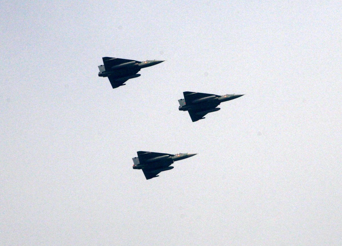

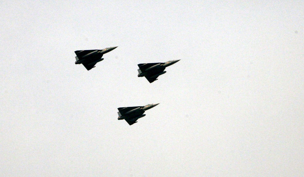

Indian Air Force Fighter Jet Tejas to Make Republic Day Debut
http://www.news18.com/news/tech/indian- ... 38098.html
Republic Day: For first time ever, India to witness flypast of indigenous Combat Aircraft 'Tejas'
http://www.catchnews.com/national-news/ ... html?seq=2
Indigenous jet Tejas to fly past Rajpath for first time this Republic Day
http://indiatoday.intoday.in/story/ligh ... 61313.html

Zee news is celebrating Tejas' arrival on republic day parade.
