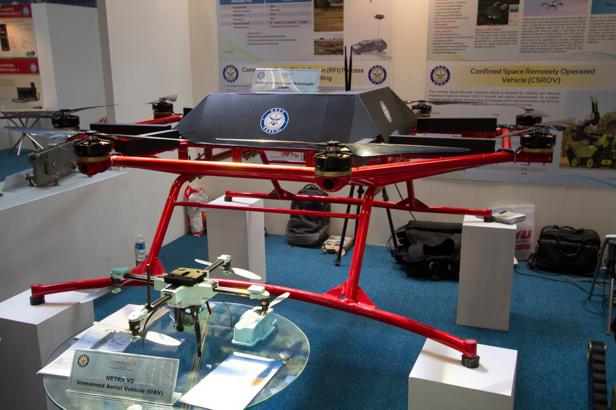

Re: Aero India 2017 - Feb 14 - 18
New DRDO Quadcopter tethered, to hoist radars
https://pbs.twimg.com/media/C4thtnXUMAAdzWK.jpg:large
