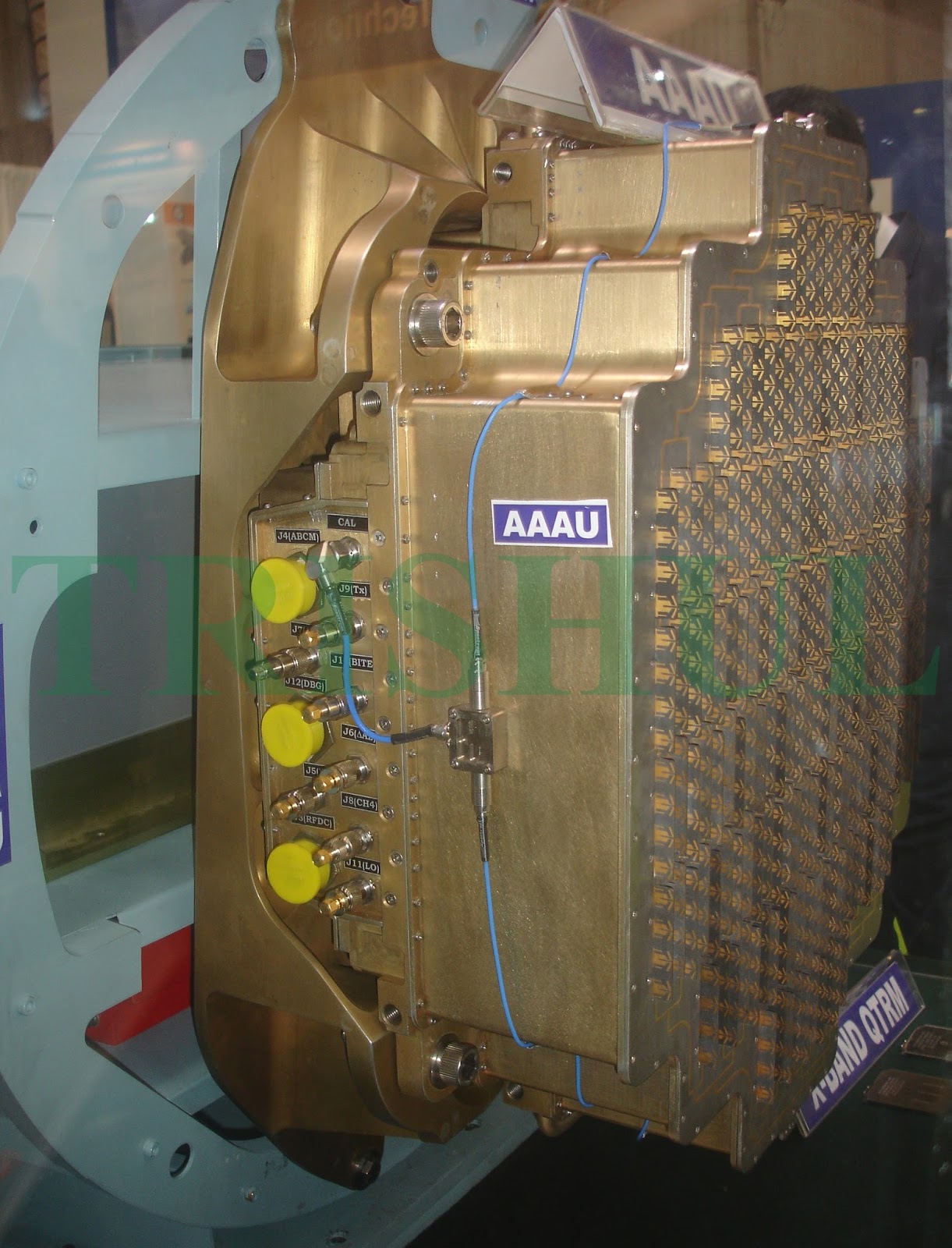

Rough estimate, 660 odd TRMs, each of around 7.9W peak power.
For reference: my post from October 2015
viewtopic.php?p=1922326#p1922326
The first BEL Quad TRM module
https://i.imgur.com/oW3Wx0M.jpg
Uttam testing has advanced its capabilities (likely). There has been a 50% range increase mentioned.
The Mk-II is also likely to sport an indigenously developed active electronically scanned array (AESA) fire control radar currently under development by DRDO's Electronics and Radar Development Establishment (LRDE) under Project Uttam. Hardware has already been realized for this radar which has a range of 100 km and rooftop testing is underway. Apparently December 2015 has been set as a time for both DRDO & the IAF to take stock of the maturity of this radar since the IAF wants clarity on the radar front for the Tejas Mk-II. Though the Uttam AESA currently weighs 120 kgs which is some 40 kgs more than the current MMR, there will be no problem in integrating it with the Mk-II which can easily carry a radar of this weight. So if the end-2015 stock taking exercise satisfies all stake holders, Mk-II will definitely feature LRDE's AESA once it completes development. In fact this radar if successful is also intended as an upgrade package for the IAF's Jaguars and Mig-29s and the Indian Navy's (IN's) Mig 29Ks.
https://twitter.com/sjha1618/status/568460816208367616
The experience in making AESAs has advanced significantly thanks to AEW&CS but a fighter FCR is not easy.
Astra mentions 10W per x-band TRM (versus BELs quote of 8W)
2015
X-band T/R modules: Partnered in the development of the product. Astra has already supplied two modules of X-band T/R. The user is testing the same. Astra expects orders for AESA radars from Tejas to come after four-five years.
T/R Module Chipsets: The MMICs in the transmit chain can cater to power levels of 38dBm in C band and up to 10W in X-band. Astra also supports with the required driver amplifiers and medium power amplifiers to achieve required power levels at the Transmitting Antenna. These power amplifiers feature very good PAE and hence consume lower power.
The real interesting part is this.
X-Band TRMs are used for QRSAM FCR as well. They are also Quad-TRMs. If DRDO is using the same modules for both programs, thats a large production run (and hence better cost).

Karan M wrote:Some good soul can work out the number of TRMs.
https://3.bp.blogspot.com/-zsoi1d5JgCc/ ... Barray.JPG
736?
