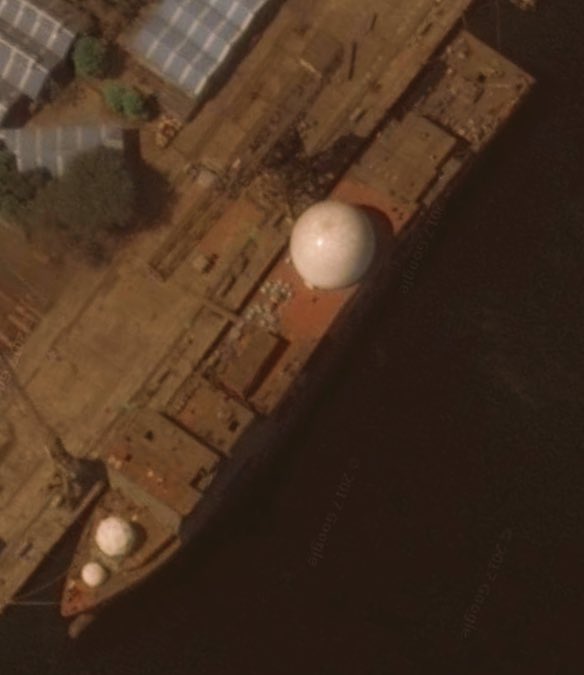

@livefist wrote:Spotted! India's 1st BMD ship shaping up at Vizag shipyard. Our report from January. https://www.livefistdefence.com/2017/01 ... essel.html … (Image cleared for release)
