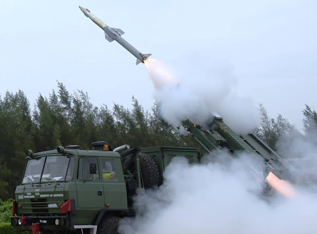

That is a canister launch.
Re: Indian Missiles News and Discussions-May 2017
^^Nice pics!
Looks like we have a different propellant compared to the Astra.. quite a bit of smoke here, compared to the smokeless motor in the Astra..

Any technical reason why QRSAM type missiles have to be launched after halting? (Considering that ship & sub launched missiles can be launched from moving/rolling platforms)
By training the cannister, it saves the seconds it takes a VL missile to align after launch. A QR missile is a last ditch effort missile unlike LR and MR, so time is of utmost essence saved by aligning the launcher before launched. Which is why even US RAM missile uses a trainable launcher. Longer ranged missiles like ESSM or Standard or LRSAM use VL.Nitesh wrote:One question why QRSAM is not vertical launch?
On a ship, the missile, search & track radar, datalink and diesel generators are mounted on the same platform and travel together.Prem Kumar wrote:Any technical reason why QRSAM type missiles have to be launched after halting? (Considering that ship & sub launched missiles can be launched from moving/rolling platforms)
On land they travel on different trucks and trailers.
Typically the diesel generator needs to be connected to radar and command centre via cables to provide power, so all of these need to halt & set themselves up. The missile launcher cannot loiter beyond the datalink range from command centre, so it too halts. Also, cabled datalink to missile launcher for initial cueing is jam and interference proof.
It's called firing from short halts.

^^^ Does the Tatra truck in the pic have a left hand drive ?
It does. This means it is from imported-but passed off as made by BEML - stock which was part of the earlier scam.srin wrote:^^^ Does the Tatra truck in the pic have a left hand drive ?
BTW - how come no one noticed TATA POWER SED written on the truck?
^^ LOL. I completely missed that one.
If it takes a QRSAM role, it may have a trainable launcher like SeaRAM. VL launch will require missile modification with TVC fins like Barak-1 and LRSAM. QRSAM doesnt seem to have TVC fins, though prima facie looking at the photo it does seem to have multiple exhaust nozzles like Nag rather than an unitary one.Nitesh wrote:Thanks sir, so we will see a different version for IN, in case it has to be adopted for naval role?
Trucks are refurbished and reused too once an older program is completed. Reusing saves the trouble of requesting additional funding and waiting endlessly for approval.rohitvats wrote:It does. This means it is from imported-but passed off as made by BEML - stock which was part of the earlier scam.srin wrote:^^^ Does the Tatra truck in the pic have a left hand drive ?
Tata Power SED probably made the launcher and C3 like they did for Akash & Pinaka. Highly unconventional to have a private player's name on a Govt Project, but guess times are changing (for the better).
