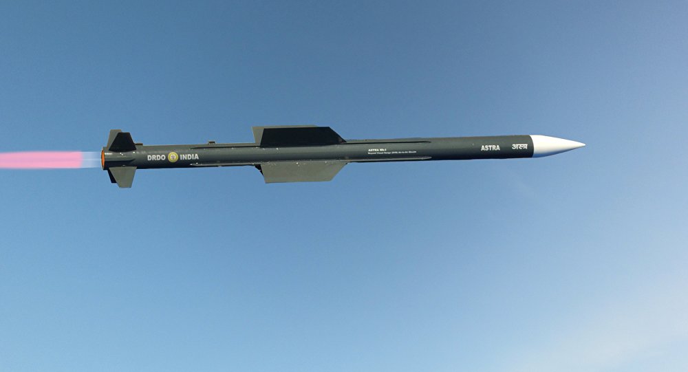

wow dil garden garden ho gayahanumadu wrote:
Re: Indian Missiles News and Discussions - May 2017
^^I did an image search and this seems to be originally from wikipedia though I got it from my twitter feed. Probably a photoshop and not from an actual test.

LivefistVerified account @livefist 10m10 minutes ago
More
NEWSBREAK: India's ASTRA beyond visual range air-to-air missile completes development trials with 7 fresh tests from a Su-30.
http://www.thehindu.com/news/national/a ... 692931.ece
The missile was tested in various missions and all sub-systems including the indigenous radio frequency seeker performed accurately, meeting all the mission parameters and objectives.
Two missiles were also launched in the combat configuration with warhead and the targets were neutralized, the statement added.

Successful Development Trials of Astra Missile -PIB
The final Development Flight Trials of Astra - Beyond Visual Range Air to Air Missile (BVRAAM) were successfully conducted over the Bay of Bengal, Off the Coast of Chandipur, Odisha during 11-14 Sep 2017. A total of seven trials were conducted against Pilotless Target Aircrafts (PTA) successfully.
The missions included engagement of target at very long range, engagement of high manoeuvring target at medium range and multiple launches of missiles in salvo to engage multiple targets. All the sub-systems including the indigenous RF Seeker performed accurately, meeting all the mission parameters and objectives. Two missiles were also launched in the combat configuration with warhead and the targets were neutralized.

Brighter Image
Looking at the pictures I have a megawatt smile on my face.
This has to be intigerated with every single fighter in the fleet as of yesterday.
Gorgeous! A great day indeed!Kakarat wrote:Brighter Image

Is there a love icon in BRF?Kakarat wrote:Brighter Image
