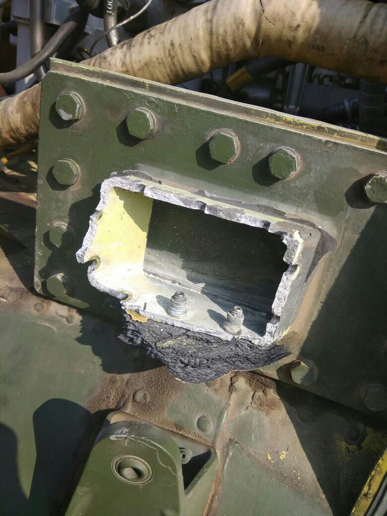

shiv wrote:This accident is a classic example of how new and unexpected things turn up when a machine goes into regular use. Now that part will be inspected for stress failure in all the Dhruvs in service.
+1 New SOP for evaluation will take place and perhaps a redesign or two. Unfortunate someone got hurt, hope they are okay and recover quickly. Luckily it isn't a issue with the core machine!
I did not realize that there were bolt holes in there.
ramana wrote:JayS, I was wondering if the stress guys reviewed the design? Putting bolt holes at the point where the bending moment is the highest for a cantilever seems a design weakness.
That is my thought too. But I am not a structural engineer.
ramana wrote:Need to look at the mating boom part. Both will tell the story.
Posts: 60361
Those fasteners are called pin(bolt) and collar fasteners. The brand name in US is Hilok. They have a predetermined preload based on the collar breakoff and are very effective fasteners. Either High tensile strength steel or Titanium.
Looks like 1/4" fasteners.
The joint seems to be transition between composite (beam part) and base adapter.
The outer beam looks graphite epoxy see the rattle snake pattern hatching?
The beam failed in the base material (grey part). The tension in the upper part caused the material to fail in bearing.
The pins did not fail.

From the pics, not just the none-metallic outer pylon, even the inner metallic one also seemed to have snapped off at the bolt holes.
JayS
Posts: 4567
Post by JayS »
hnair wrote:From the pics, not just the none-metallic outer pylon, even the inner metallic one also seemed to have snapped off at the bolt holes.
Its actually the inner one which failed. The outer part would have had a clean separation if not for the two intact bolts at bottom. Note that this part is upside down in the picture. Its material failure of the base block. All bolts are intact.
I was thinking of single line of bolts. Now that we see multiple lines, its clearly a block shear type of failure. Only its more like block tensile failure. Block shear is common type of failure seen in even steel structures. The base block material doesnt seem to be ductile or else we should have seen elongated bolt holes. I cant see them. I have been resisting the feeling that its composite too. Because it makes more sense to have a metallic block there.
Ramana Sir, its definitely CFRP. In the first picture itself we could make that out from remaining portion of it. Thats how I colcuded its Composite right in the beginning.
Posts: 60361
Exactly. Chopped fiberglass and not Metal
Then failure can be explained.
It's difficult to control it's properties.
Posts: 60361
So it's a CFRP load transition block to which composite boom is attached with those pins and collars. That explains the pin and collar which are common for composites.
JayS
Posts: 4567
Post by JayS »
ramana wrote:Exactly. Chopped fiberglass and not Metal
ramana wrote:So it's a CFRP load transition block to which composite boom is attached with those pins and collars. That explains the pin and collar which are common for composites.
OK, some misunderstanding.?? I was referring to the boom, not the base block. The boom is definitely CFRP. I have half mind to think the base block is also composite looking at the type of failure, but from the exposed failed material section it doesn't look like composite. Also logically speaking one would use metal base block there. It looks like metal but failure looks brittle which is bewildering.
Glass Fibre (GFRP) will not be preferred for Aerospace application where the member is any type of load carrying let alone the primary load carrying member as its in this case. GFRP typically is used in places where high strength is not needed, weight is not critical, deflection is not critical factor, higher toughness is desired and most essentially cost is a important factor. Typically GFRP have lower stiffness but higher toughness. Some type of glass fibre can match Ultimate strength of CFRP but CFRP wins hands down in weight factor, but its significantly costly too. Only place where GFRP might be preferred over CFRP is in Radome due to their EM properties. Chopped GFRP is even cheaper type used in non-critical locations only, even in Auto industry.
One possible explanation could be quality issue of the metal in some batches. Material properties vary in a band and once in a while some batch tends to have lower than desired properties. Or it could be due to issue in Heat treatment.

The failure is quite probably fatigue induced. Marks are clear. I will try to post a pic highlighting striation marks along with locations where crack initiation happened when I get some time.
Zynda wrote:The failure is quite probably fatigue induced. Marks are clear. I will try to post a pic highlighting striation marks along with locations where crack initiation happened when I get some time.
Would appreciate that - I also saw a window/tear in the metal inboard of the actual break and felt it might be fatigue.

JayS,
Chopped fiber also won't see the fiber. We need a good picture.

ramana wrote:shiv If you can please post that too. It could be load transfer to the helicopter structure.
Ramana - you can see a jagged buttonhole tear on the top right of the inner metal rectangle just inboard of the line of shear in the image posted earlier above. The tear runs parallel to the shear line. as if the metal has been stretched repeatedly.The outer part is obviously fibre
https://pbs.twimg.com/media/DTOtlHbVAAAhuMS.jpg

Shiv, I see it now. The tear or crack is due to the tension load. They grow only in tension loads. The tension load failed the joint at the pins. Or else it could have torn at that year or shear line.
As JayS says definitely a flaw in the material manufacture. Could be inclusion in ingot, heat treatment , flaws during the extrusion or rolling.
Thanks for pointing it out.
Material is a suspect.
I wonder if there was a hidden flaw that caused this crack to grow under repeated loading. This is the fatigue part. But the metal broke for some other cause at the pin holes.

ramana wrote:JayS,
I would expect fibres on the failed section whether its chopped or weaved. Generally glass fibres are chopped to like a inch or two length. (Using a finely chopped fibres would be basically defeating the whole purpose of using composites because it would give isometric properties more like metal). We should definitely see fibres poking out, it if was glass fibre.
In fact it seems metals are quite capable of this kind of brittle-like abrupt failure in the event of catastrophic failure without any appreciable signs of plastic deformation. Typical fatigue failure is a good example. But why I was not able to think of it as an obvious explanation is I cannot think how can such simple design fail like this without any indications by significant deformation. A good design, at least for such places where lives are at stake and are such simple regulation bolt joints, should have bb such that the metal would yield giving significant and sufficient warning of failure before it breaks completely. My most expected cause is some defect in the material, the material not being up to the specs (in other words quality control failure).
Also, when I said these kind of designs have significant FoS, it didn't mean by the single figure we use for defining Ultimate load using 1.5x Design load. The design methodology for bolt designs is typically based on simple theory which is highly conservative. I would have designed this particular bolt joint using hand calculations. That keeps it simple and conservative. When you design for 200kg the method ensures that it would withstand perhaps 400-500kg load without any kind of failure. On top of it you add FoS.
Shiv, the top part in that picture actually would be in the bottom when its attached to the base block, as I explained earlier in one post. Two bolts in that location still remained attached to the base block with a part torn off of the outer boom composite part, because that part is under compression. The failure would have started at the top since its a classic 'bending in cantilever' case. (the picture itself looks like its rotated upside down from its true orientation or the person held mobile camera upside down while taking snap. I think I see the floor tile on the top).

JayS wrote: Shiv, the top part in that picture actually would be in the bottom when its attached to the base block, as I explained earlier in one post. Two bolts in that location still remained attached to the base block with a part torn off of the outer boom composite part, because that part is under compression. The failure would have started at the top since its a classic 'bending in cantilever' case. (the picture itself looks like its rotated upside down from its true orientation or the person held mobile camera upside down while taking snap. I think I see the floor tile on the top).
Yes that is exactly what it appears like.
Here is the Helo side:
https://pbs.twimg.com/media/DTPDfkTU0AEk4Qi.jpg
On the helicopter side the rectangular boom shows a clean break on the upper part and one side and the tear is on the opposite side. The torn part would have been last to give I guess. That bar is subjected to what I think are called "torsion" loads because the rope with men is always swinging and not hanging directly down with no movement. It has been stressed round and round and round until 2 sides have failed at the bolts and the rest has simply torn off.

The picture of the broken boom shown inlined in Indranil's post (above) quoting ramana (
https://pbs.twimg.com/media/DTOtlHbVAAAhuMS.jpg) , seems to be a different broken boom than what is shown here https://pbs.twimg.com/media/DTPDfkTU0AEk4Qi.jpg bosted by shiv.
One can count 6 (or 8 ) bolts along the perimeter of the failed boom in ramana's picture. There are no bolts along the perimeter in the link by shiv. There are other bolt locations too that look different. Is each one the mating side of the other? If so, it is not clear that they fit each other.
Added later: Seems plausible that they are mating portions of a single part.
It looks really long and thin to take too much load.
SriKumar wrote:The picture of the broken boom shown inlined in Indranil's post (above) quoting ramana (
Image) , seems to be a different broken boom than what is shown here Image bosted by shiv.
Both the images don't look like they are from ALH. Look at the background to what they are attached to and the above pictures. Looks totally different.
SriKumar wrote: Added later: Seems plausible that they are mating portions of a single part.
Yes. They are mirror images.
srai wrote: Both the images don't look like they are from ALH. Look at the background to what they are attached to and the above pictures. Looks totally different.
One is the end of the boom and the other is the helicopter side. You need to turn one image 180 degrees to "mate" them

Before we start a twitter war about this being tested for 2 soldiers only, can we really confirm its there?
Cybaru wrote:Before we start a twitter war about this being tested for 2 soldiers only, can we really confirm its there?
We would need to know the design load limits qualified for that slithering boom extension and the designed fatigue life tested.
Other questions:
What the was the load factor during that particular event?
How many times that particular piece was used under what conditions?
When was the last time it was checked for failures? What is the maintenance schedule for it? What sort of failure analysis are done on it to keep it safe for use?
What was the standard SOP and has that been in practice at all times (or most times)?
How are other booms doing under fleet-wide checkup post this accident?
etc.
Not a simple straight-forward answer. After a detail investigation, we might come to know the series of events that lead to the structural failure of the boom. It's too soon to pass any judgement on this matter without knowing all the details.
