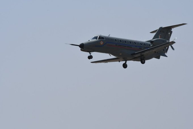

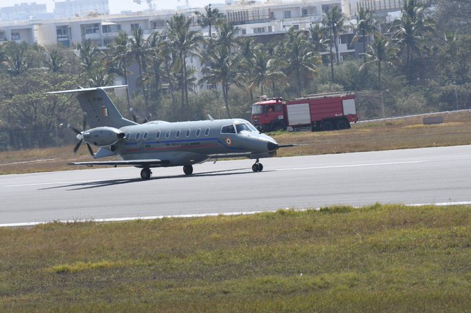

Link to Video of Saras PT1N flight 2.
https://www.nal.res.in/cms/medias/video ... 20-1mb.mp4
Is 2:04 min long and is 476 MB. By looks of it, must be 4K resolution.
And yes, predictably the 'Light' bug has bitten Saras too. It is being called Light Transport Aircraft. :)
LCA, LCH, ALH, and now LTA.

Re: Indian Military Aviation - 21 Sept 2015
I saw it yesterday around 11.15am.
it was a short flight like maybe 10 mins.
a kiran trainer was flying close formation to keep watch.
from below it looks like a A10 warthawg :twisted:
