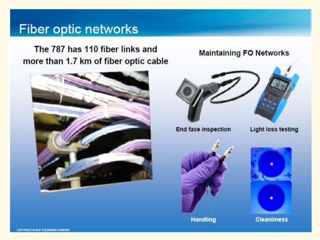

Re: Tejas Mk.2 News & Discussions: 25 February 2018
i think not just bandwidth and weight saving, but a single fiber can replace many bundles of individual copper cables.
a commercial plane using copper wires would be 10-20km of cable for sure
like this
using limited runs of fiber it might be possible to have more protection in a fighter than masses of copper wires all over.
Bart S

Post by Bart S »
Neshant wrote:Differential signalling on copper lines has reasonable noise immunity - though its slow.
It takes quite a lot to damage a copper line physically to a point the signal no longer gets through.
Not sure how robust fiber optic lines are in a military system.
They are fast and light weight, no doubt and perfect for video based applications with multiple, heavy data feeds.
Other than the bend radius needing to be respected, there is no other real issue with fiber reliability vis a vis copper. In fact a lot of commercially available fiber cables are designed with a lot more toughness built in than the average copper cable, there are cables that are heat/water resistant, rodent bite resistant, designed for being laid directly in the ground without a protective conduit for outdoor applications, etc.

Dileep wrote:There will be fiber optics on MK2, way beyond what you imagine.
Recall seeing that in earlier Tejas Mk2 proposals. Good to know that it is planned still.
The weight of the cabling on the on the Tejas is supposed to be ~400 kgs or so. If that could be reduced by a couple hundred kilos, it would be good for lowering the empty weight.
Dileep
Posts: 5892
Joined: 04 Apr 2005 08:17
Post by Dileep »
There are multiple roles for fiber on board.
1. Data acquisition system
2. Mission and Display system
3. Fiber Optic Sensors
4. Flight control (the least priority)
1 and 2 will happen in MK2 most likely.
Apart from weight saving, there is space saving too. There is pretty little space to pull cables, and the operators need to literally bend over backwards to manage the cabling.
Fiber do have its disadvantage as well. The end to end reliability is often LOWER because of the optoelectronics at either end.
in the Mk1A thread it is said the Tejas has 40km of cables on board. thats a lot. weight savings will be big if they can combine the data carried by multiple cables .... because additional weight of the optical modules at both ends have to be +added ...
things have been getting smaller....back in 2012 the CFP on the left was as big as a cellphone and heavier in weight , now CFP4 is pretty small.
there is also a "breakout" mode of operations. like you can use a 40Gbps optic module but have 4 octupus wires hanging out and connect 4 x 10Gbps at the other end. this is pretty routine now. same for 100->10x10. it was a rage a jasba for 40->4x10 and 100->10x10 back in 2012 when i was working in that area on new boards including "combo" boards like 100 + 40....because most customers could not fill a 40/100 pipe back in those days our long haul lines in india were at 10gbps (and in cheen 40gbps) so they wanted to split into bite size 10gbps chunks and use in different directions.
this one is fiber cable but there is also light blue colour copper variant.
