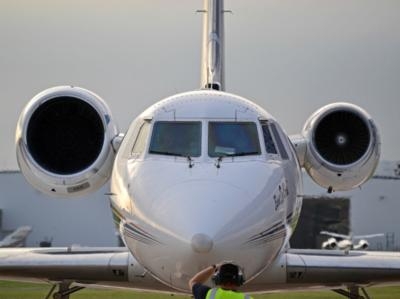

Re: Kaveri & aero-engine discussion
sncema silvercrest business jet engine program
http://www.aero-news.net/index.cfm?do=m ... 1cfc2ba06a
The modified Gulfstream II flight test airplane arrived at Kelly and December 2, 2015. The 1970’s-era Gulfstream II was extensively modified for the SAFRAN/SNECMA Silvercrest test program, with custom-designed engine mounts and other hardware manufactured by SWAT’s sister company, Sierra Industries of Uvalde, Texas. In addition to engine mounting and structural modifications, the aircraft includes newly engineered electronic engine controls and a completely separate electrical and hydraulic system for the new engine. The project also included the design and installation of extensive in-flight monitoring and test equipment.
