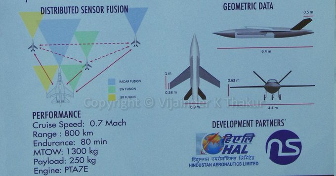

From AI19: HAL's unmanned wingmann will use PTA7E engine.
From Twitter thread: https://twitter.com/vkthakur/status/1102836188002435072
1. The time to reenigne the Jaguars are now (or never). An afterburning HTFE is at least 6-7 years away! So, although HAL says it cant fit the HTFE on Jaguars, it's almost impossible.
2. It is the right time for them to think of a NG HJT/LIFT/LSA powered by HTFE. Empty weight: 4.5 tons. CTOW: 6.5 tons, MTOW: 10 tons. Supersonic at altitude. 7 hardpoints. AESA primary radar. Litening.
3. Would love to see Manik scale up to the 0.7 ton thrust class. Would a good replacement for the PTAE-7 engine.
