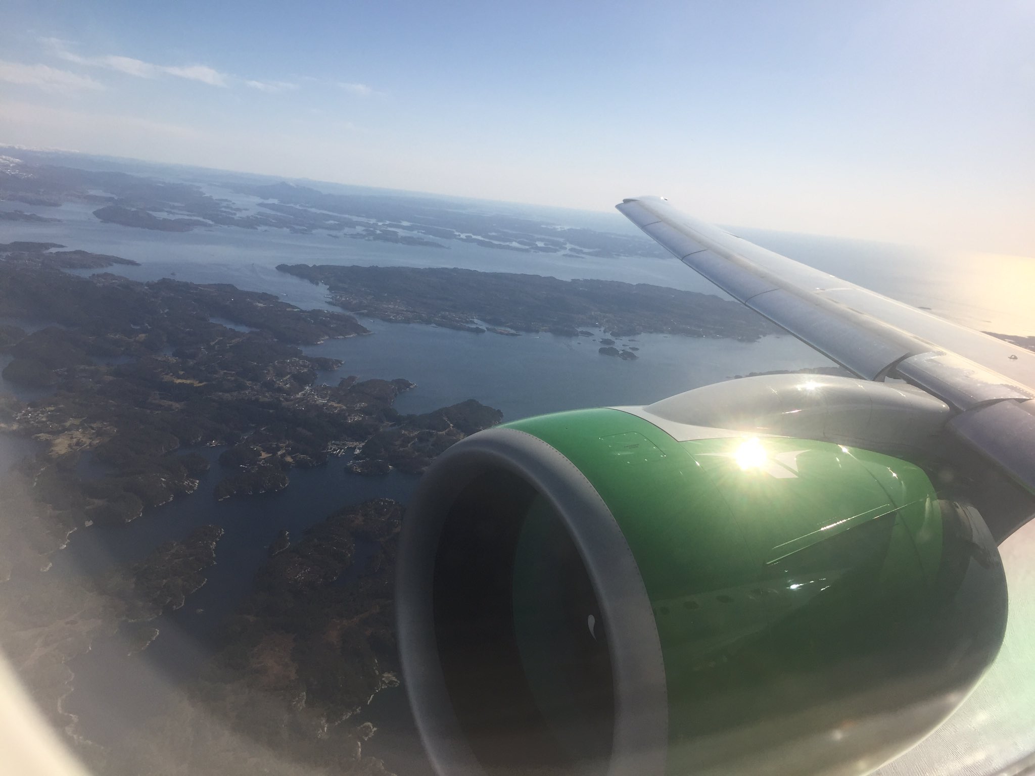

A few days ago while boarding the A320, I noticed that each engine cowling had one prominently downward slanted vane on the outboard side.
That would possibly reduce any unwanted lift produced by the engine cowling itself.
At higher AOAs, the max8's new and bigger engine cowling does produce considerable lift on its own, which possibly causes the MCAS to compensate that much more, thus complicating further an already complex situation.
chetak wrote:A few days ago while boarding the A320, I noticed that each engine cowling had one prominently downward slanted vane on the outboard side.
Can you show by any pics what you mean by this ......Sorry I dont get this. Visual rep may help to understand this
as a representation, this is on the embraer E190
