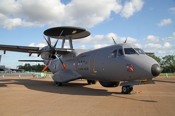

Defence Ministry Completes Negotiations To Buy C-295 Aircraft; Approval From DAC After Lok Sabha Elections
Apr 15 2019,
the aircraft in the picture is only for representational purposes
While the negotiations to acquire C-295 aircraft have concluded, the deal is expected to be approved by the Defence Acquisition Council (DAC) only in June after the Lok Sabha elections, reports The Hindu.
“Negotiations for the C-295 deal have been completed. However, the deal needs clearance from the Defence Acquisition Council (DAC) as there is a change from earlier parameters,” said a senior defence official.“The next DAC meeting will be held in June. So we will push the deal at that time.”
India is looking to buy 62 Airbus Defence and Space C295 medium transport aircraft (MTA) for the Indian Air Force (IAF) and the Indian Coast Guard (ICG) from the Tata Advanced Systems Limited (TASL).
The firm is a joint venture (JV) between the Tata Group and the European aerospace giant Airbus. The EUR 2.8 billion ($3.15 billion) deal will deliver 56 C295s for the IAF to replace the ageing fleet of Avro 748M transports, and six for the ICG.
Make In India
Under the deal, while 16 C295s will be imported, the remaining 46 aircraft will be assembled at a facility to be set up by the JV near Bangalore. Also as per the 2013 MTA tender, 24 of these will be imported in kit-form for local assembly and contain 30 per cent locally-sourced components. However, the remaining 22 platforms will have 60 per cent of the parts sourced from domestic manufacturers.

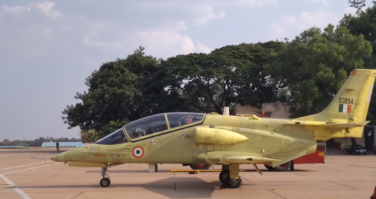

https://twitter.com/livefist/status/1118762958966939649
After nearly 3 years grounded following spin test flaws, HAL’s HJT-36 Sitara intermediate jet trainer back in the air with modifications. Photos from the flight:
Kakarat
Posts: 2221
Joined: 26 Jan 2005 13:59
Re: Indian Military Aviation - 06 March 2019
Post by Kakarat »

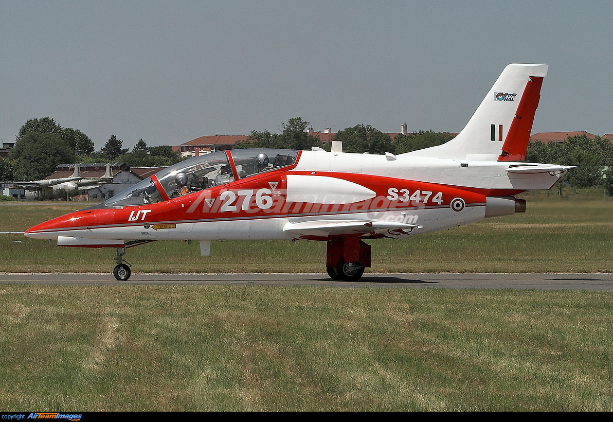

Now I request BRF aero experts to analyse the image and present their views on the design modifications on HJT-36
Comparison old and new design
The vertical stabilisers has moved back to the end
ventral strakes have been added
It seems they have added strakes in front of horizontal stabilisers
Two fences per wing have been added
mody
Posts: 1440
Location: Mumbai, India
Post by mody »
The greatest value will be as a test bed for HTFE-25 engine. If the HJT-36 can be made with the HTFE-25 engine, I guess there would be some market for it overseas. For IAF, I guess they have eliminated the IJT requirement from training.
It can also serve as a basis for a twin engine AJT version. With 2, 25 KN engines, we can have a plane better then the M346 and Yak-130, which are the most popular AJTs currently.
Kakarat wrote:Now I request BRF aero experts to analyse the image and present their views on the design modifications on HJT-36
I can also see:
A winglet on the vertical stabiliser just above the number.
The rudder extends longer below the elevator.
Cover for MLG seems to have changed, maybe also having an airbrake function now.
There seem to twin winglets on either side below the engine housing.
The winglet on the spine just behind the canopy is slightly longer.

According to R Madhavan, CMD, HAL, “HAL continued its R&D efforts and undertook modification of IJT LSP4 aircraft based on extensive and comprehensive wind tunnel studies.”
The IJT `Sitara’ has been facing issues which has been modified from the developmental stage after it crashed in 2011. Since last year HAL has been working on putting the IJT through fresh wind tunnel tests after a design upgrade, in which the aircraft is deliberately stalled midair and recovered as part of the training process.
The Rs 2,989-crore project had started in 1999, but it failed after the trainer aircraft was unable to prove its ability to get out of a stall and spin, a critical feature needed in a trainer aircraft that is going to be used for training fresh pilots.
HAL has sought the help of UK based BAE Systems in 2014 for seeking help in re-designing the aircraft tail which could meet stall specifications of the IAF.
After passing the tunnel tests, today’s flight test was critical for the IJT and it is expected to move to the next stage of development before it is fully safe for the trainees in IAF. And can be produced for replacing the current `Kiran Mk II’ aircraft fleet by 2020. In view of several setbacks to the IJT programme caused by the structure and the weight, HAL has been forced to change its time lines atleast four times. The aircraft were expected to be inducted in 2015, but now it has been pushed to 2020.
Due to shortage of trainers, the IAF has been forced to modify its training pilots from a three aircraft plan to two aircraft plan.
The IJT is expected to provide high-speed training for IAF pilots entering the second stage of training. Fresh cadets begin flight training in a basic trainer aircraft (BTA) and then on an IJT, before moving on to an advanced jet trainer (AJT) to finally learn the art of combat flying.
