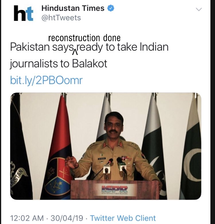

Re: Operation Balakot: News & Discussion
Hindustan Times Verified account @htTweets
Pakistan says ready to take Indian journalists to Balakot
http://bit.ly/2PBOomr
11:32 AM - 29 Apr 2019
Two Indian origin Pakistan journos already have started @dhume
