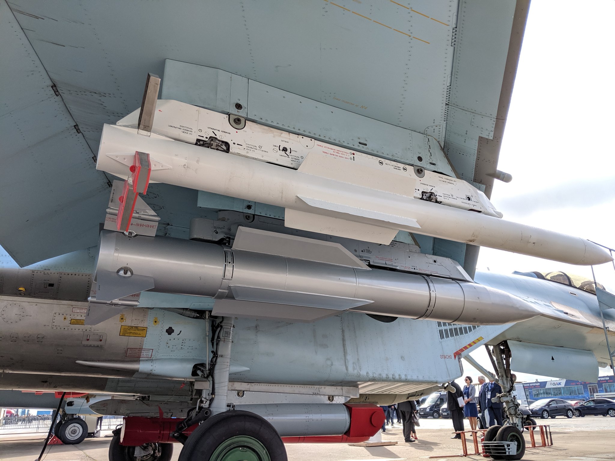

At MAKS 2019 , RVV-BD LRAAM and R-77-1 BVRAAM on Su-35 Wings
