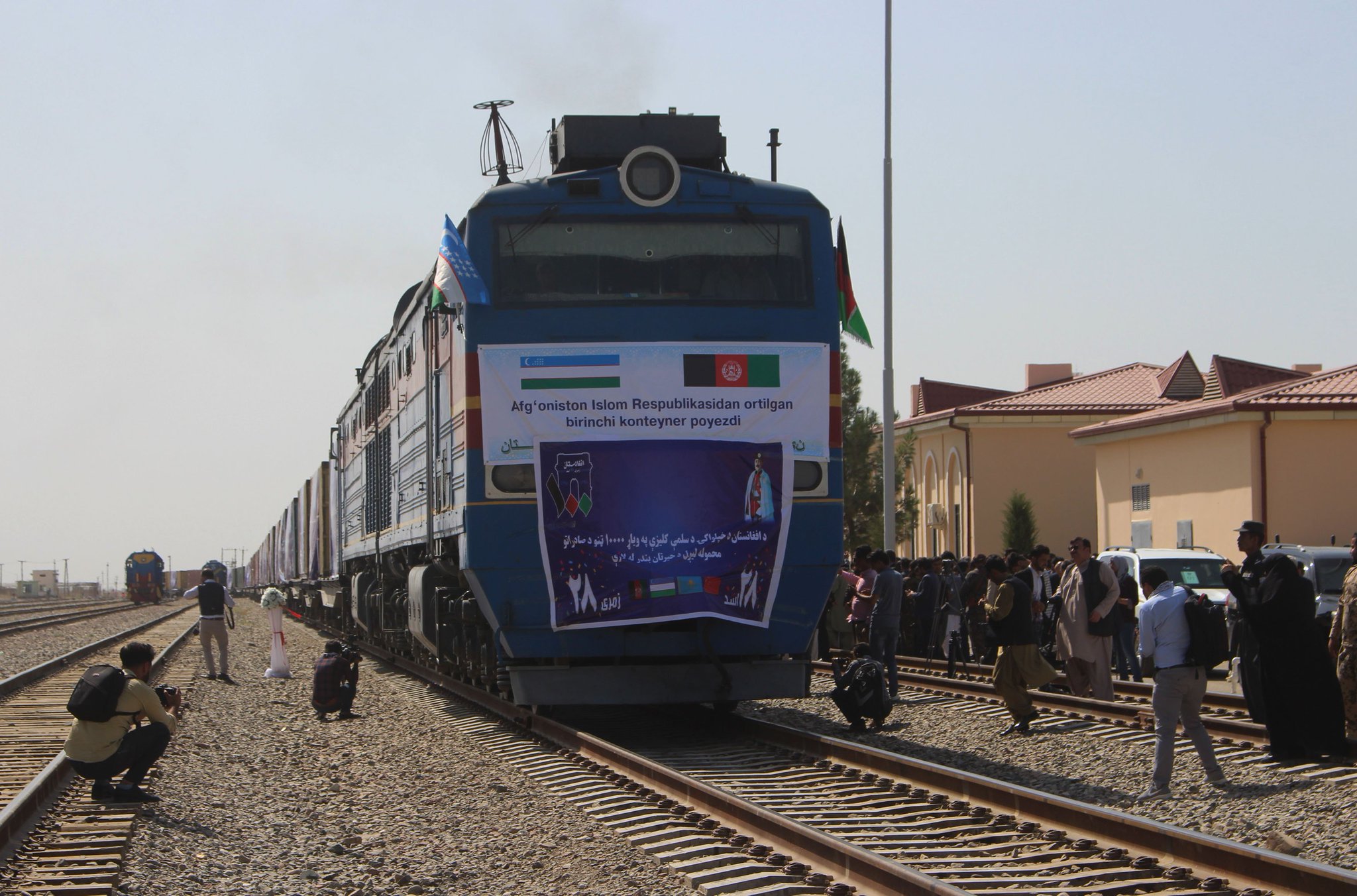

Postby chetak » 11 Oct 2019 15:12
twitter
The #IndianRailways, which does not exactly hold the reputation for being a #profit-making entity has managed to swell its coffers by Rs 35,000 crore, which is more than the annual budget of three northeastern states put together.
Photo: IANS
Image 9:09 PM - 9 Oct 2019
Posts: 16858
Postby Rahul M » 11 Oct 2019 15:25
looks like a train b/w uzb & afg. what's the relation with IR ?
