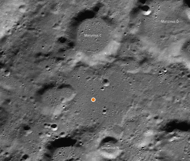

Have not followed the thread here .. sorry if missing some posts but a quick note - Some of us were checking this out..
and some calculations gives me less hope.. OTOH , all thing considered CY2 is/was awesome...
Here is the last position .. from JPL/Horizon animation .. (hard to put video, so the situation is around the last known position of Vikram.. (Green orbit is NASA LRO orange/blue is CY2, Vikram ).
By comparing the position estimated by JPL/Horizon estimation based on doppler shifts etc.. I think (Let us wait till there is some more people who are expert give it another look and calculations to check)..
According to this calculation/estimation - (which can be easily wrong as all data is fuzzy and has to be analyzed more which ISRO is doing and let us wait for that) ..
- The time the communication lost was *not* 2.1 Km from the target but when Vikram landed on the surface. (Makes the landing pretty hard.
- The speed is about 50 m/s (110 mph) again hard.
But as I said, this was done with very fuzzy data.. so if we here from Vikram obviously our fuzzy data/calculation is wrong. Anyway we will know .

For quick reference: Keep your eyes open..

Amber G. wrote:For quick reference: Keep your eyes open..
[img...]https://miro.medium.com/max/615/0*_yEr9TO7nczK24uM[/img]
any idea about at what scale that picture is? what is the 500 meter radius circle, for example?
